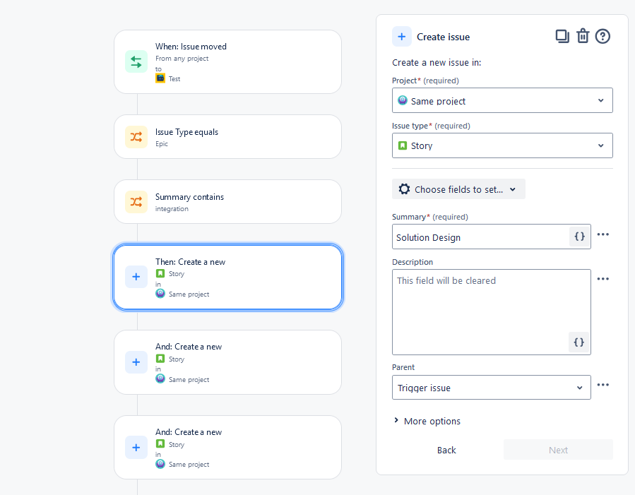

Hi @Alicia Morgan ,
you can try this for the move of the epic to another project:

Hi @Alicia Morgan
The answer that @Mike Maurer gave shows you the how to create the child tickets when the epic is moved to the specified project (you will have to change the first step to use DIS as the project name) and you may have to set the automation up as being global rather than just for DIS
To do the same thing when an epic is created, just create a second automation that triggers when an issue is created (this can be a single project automation)
