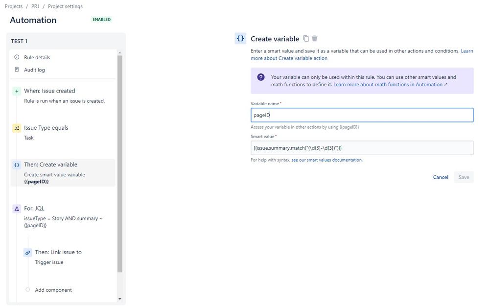

Yes, it's possible. It will be tricky to make, but it will work.
You'll have to use Jira Automation, regexp, and variables. In a few words:
1. When new issue is created, you take ID fom summary with regexp. Save it to variable.
2. Search for story with summary, where similar ID is mentioned.
3. Link issues.
I'll try to make an example

Hi, @rafters magnet0j
Sorry for late reply, but I was sure, that I posted example. It works and you can use it. It's based on regexp and smart values.
