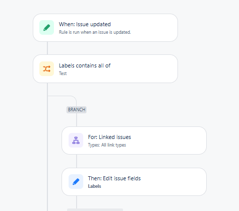

Hello everyone,
I'm trying to set up an automation, but I can't find how to fit my requirement.
I need that :
When a ticket A from any project is linked to a ticket B from a project X, and ticket B has a label = Test123, then ticket A must have a label Test456.
Thank you for your help,
Nico
Varsha Joshi
June 26, 2024
Hi @Nicolas Rigaill
You could try using the following:
Hope this helps.

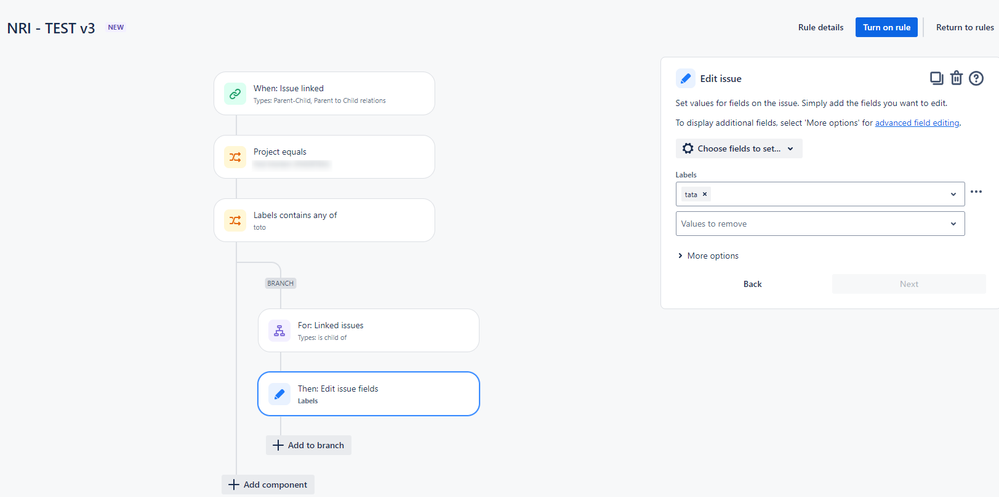

Nicolas Rigaill
June 27, 2024
Hi @Varvara ,
Thanks for your reply :)
We ended up doing something like this, and it works.
The only remaining problem is that I only have to update the "Is child of" issues.
Unfortunately, when I start a branch, if I put a filter on the link type, it doesn't find any related issue.
It works perfectly when I remove the filter.
As my client has 2 links with the same "is child of" name, I imagine this may be the source of my problem.
Thank you,
Nicolas
