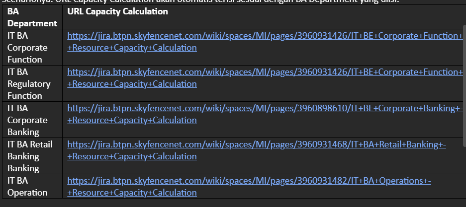

I have 2 fields, BA Department and URL Capacity Calculation.
How do I do it,
when I select the value "IT BA Corporate Function" from the BA Department field, the value of the URL Capacity Calculation field will automatically change to "https://jira.btpn.skyfencenet.com/wiki/spaces/MI/pages/3960931426/IT+BE+Corporate+Function+-+Resource+Capacity+Calculation"
I have tried the following method, but the result is not showing
I've tried removing the "https://" but it still doesn't work
Can anyone help me?

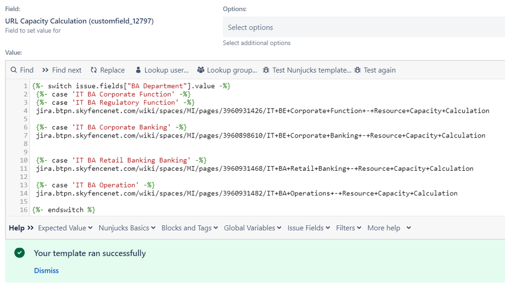

Did you "test" the Nunjucks template (using the "test Nunjucks template" button) against an issue to make sure the correct value is returned?
>> here's the result:

As you can see, testing the nunjucks template against an issue returns an empty string instead of the appropriate value. This means that the values inside the case statements are probably not exactly the value selected. It could be a case issue (upper vs lower case) or a trailing space in the single-select options. To check the exact value of the BA Department field, you can test this against the issue:
*{{issue.fields["BA Department"].value}}*
and copy the value between the asterisks (including any leading/trailing spaces)

RIZKY JTUASIKAL
May 22, 2023
Hi @David Fischer
sorry for the late reply,
and thank you very much for all your feedback!
Now it's working properly
