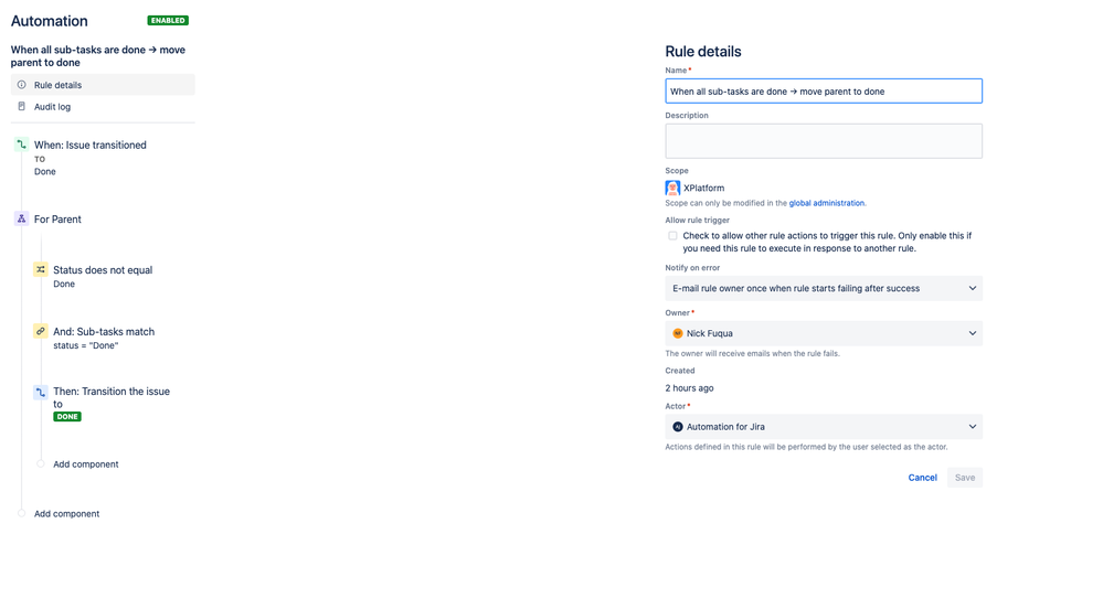

Hello @Trudy P Claspill ,
Thanks for the quick response. I am using the automation feature. I got the automation from the library of the feature. I've attached a screenshot of the rule configuration below.

Can you confirm that the automation rule is running when you execute the transition of a sub-task to Done? Are the runs of the rule showing up in the Automation Audit Log? Are there any errors reported in those audit log entries?

Hi @[deleted]
Please consider adding a condition after the trigger, checking that the issue type is a Sub-Task.  Otherwise other issues could attempt to process this rule.
You may see that in the example rule I believe you are following from the library:
https://www.atlassian.com/software/jira/automation-template-library/rules#/rule/140671

Deleted user
March 1, 2021
@Trudy P Claspill The only entries are configuration changes from when I added the rule and made small changes to attempt to troubleshoot the rule. I do not see any success or failure entries.

@Bill Sheboy
hi Bill, thank you for the suggestion. Wouldn't the component that is checking the sub-task status suffice for this since it is only running the check on sub-tasks? Sorry if this is a dumb question, I'm just trying to understand.
The desired outcome is that any issue (bug, story, etc) that has subtasks should auto transition when all of its subtasks have been completed.

Bill Sheboy
March 1, 2021
Hi, Nick.
To confirm: is this a Classic or Next-Gen project?
Looking at your rule trigger, any issue can trigger that and then try to branch on the Parent.  The extra condition ensures your rule bails out (or continues) as expected as soon as possible.

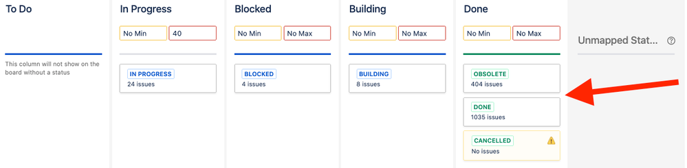

Trudy P Claspill
March 1, 2021
@[deleted]
Look at the Board Settings > Columns and see if there is more than one status that is colored green. They may all be in your Done column or you might find them in other columns or in the Unmapped Statuses area.
Deleted user
March 1, 2021
@Trudy P Claspill
There is only one status in that column, which is the one I am using with this automation rule.
