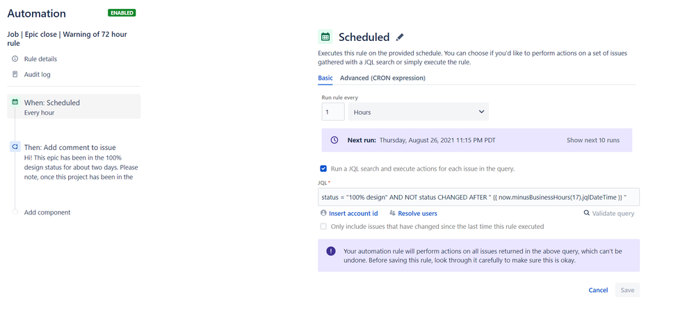

I am trying to create 2 automation rules in workflow in the following instances.
Automation 1
>> when the workflow for epic has been in `100% design` status for 2 business days, a comment will be placed on the epic giving warning to the user that the issue will be closed out
Automation 2

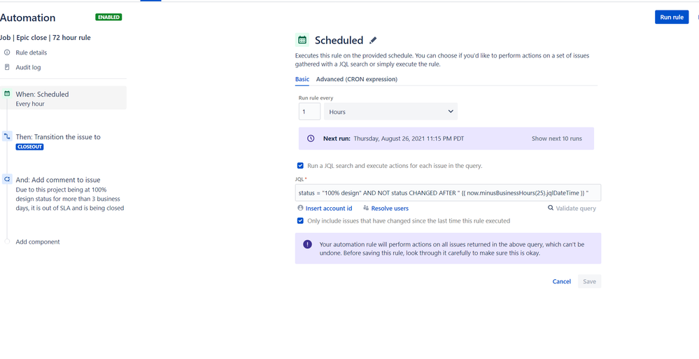

>> when the workflow for the epic has been in `100% design1 status for 3 business days a comment is made and the epic is transitioned to the closeout task from `100% design`

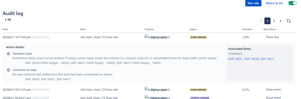

Please see attached screenshot which shows the two automations and the error log for the 2nd automation

Hi @BrentBot,
I would check the transition part in your rule. According to the error message, the destination status can't be found.

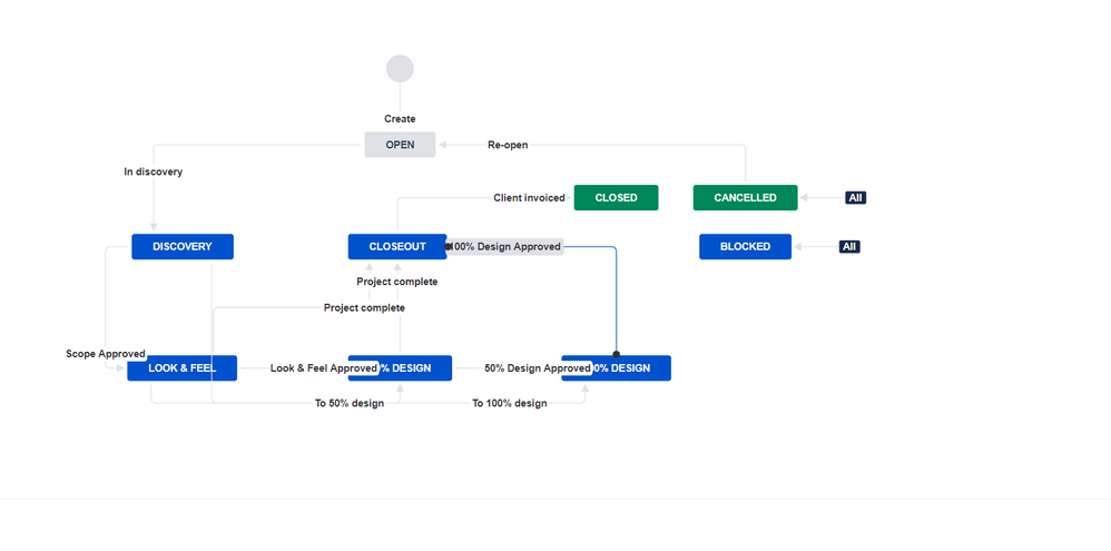

I do not - the only additional thing i have is a post function for setting the resolution. See attachment.

Here is the current JQL in the schedule
status = "100% design" AND NOT status CHANGED AFTER " {{ now.minusBusinessHours(25).jqlDateTime }} "
I have tried to add project and issuetype to the expression but to no success.
side question, should i have the checkbox `Only include issues that have changed since the last time this rule executed` selected
I'd say I wouldn't check it now for testing, but to run it in production it's a good idea to not check the same issues again.
