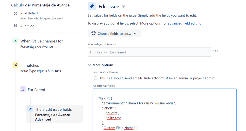

We add a screenshot of the standard as it is, but we still need to complete the additional fields section:

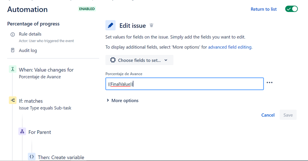

Hi @Bill Sheboy, thanks for your help
We have tried to perform operations using lists, but the final result is not satisfactory.

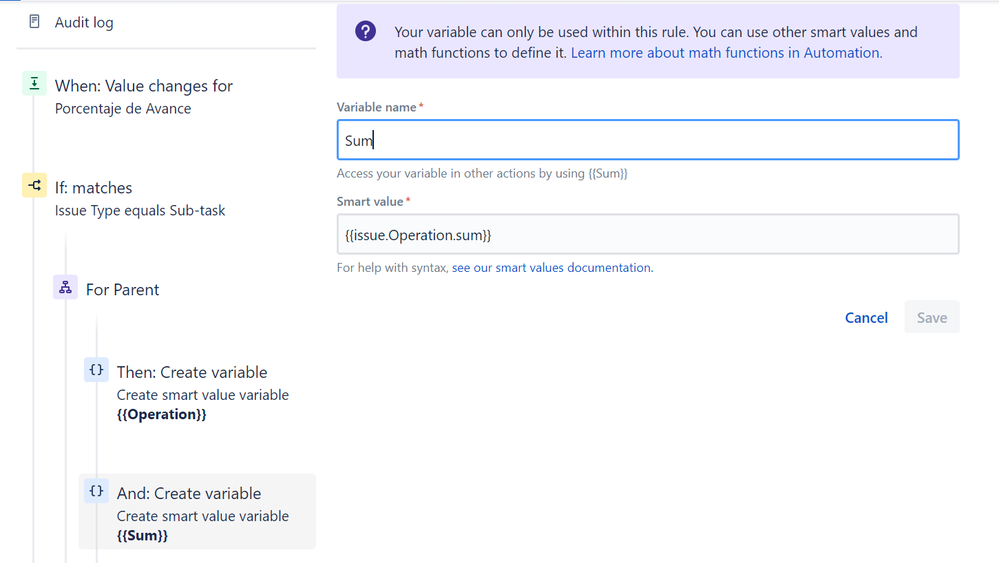

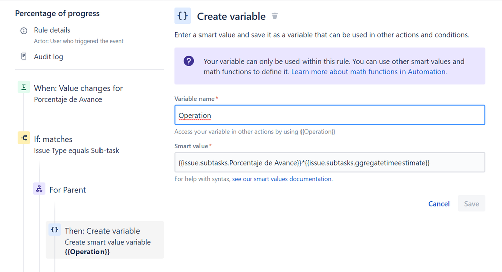

First of all, we have created the variable "operation".
Then, the variable "sum".

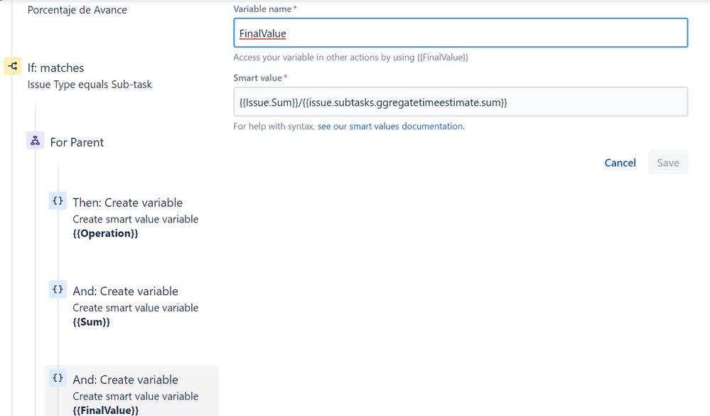

Finally, the variable "FinalValue".

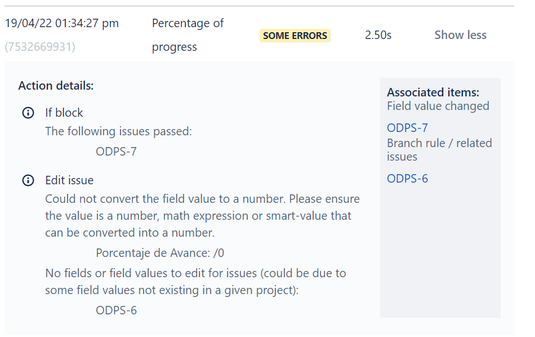

Then we call the result value and we get the following error
Could you please help us solve this problem?

There are two ways to perform most of the math operations with smart values:
Inline with dot-expressions:
{{issue.myFieldA.multiple(issue.myFieldB).divide(10)}}
With the {{#=}}...{{/}} syntax.  The equivalent of the above would be:
{{#=}} {{issue.myFieldA}} * {{issue.myFieldB}} / 10 {{/}}
Please look here for more details on these methods:
https://support.atlassian.com/cloud-automation/docs/jira-smart-values-math-expressions/
Also please note: there is a typo in your FinalValue created value expression where "aggregate" is misspelled.
