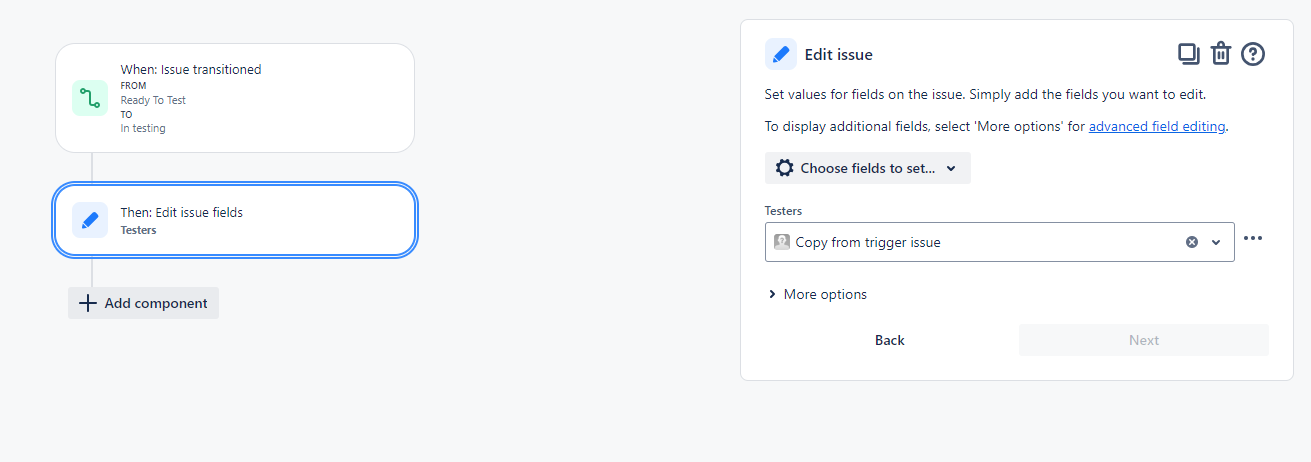

Hi!
I have a custom field created by me with the User Picker type, let's call it "Testers". Now, I want to do automation so that in my project, when moving the status from "Ready To Test" to "In testing", this field is assigned the value of the user who transferred to this status.
In automation, I chose:
When: Issue transitioned From Ready To Test to In testing
Then: Edit issue fields "Testers" selected the type "Copy from trigger issue"
But it doesn't work. Tell me what to do?
P.S. if you select Assignee in automation, then there is a "User who triggered the event", in this case it works. But the trouble is that the custom field does not have such values.

Hi @a_makharov
Instead of picking from the list of values in the UI, I would try to set the field to a smart value, specifically {{initiator}} or one of its attributes.
a_makharov
October 17, 2024
I've tried this too, but it doesn't work.
Jim Knepley - ReleaseTEAM
Atlassian Partner
October 17, 2024
Can you be more specific about what happened when you tried? Does the Testers field end up blank? Is it set to an incorrect name? Is there an error?

a_makharov
October 17, 2024
Atlassian Partner
October 17, 2024
I would try setting the field to {{initiator.accountId}} first, and if that doesn't work try using the Advanced field editing using JSON approach.
a_makharov
October 17, 2024
Oh, sorry, i used smart values incorrect, {{initiator}} works right.
"fields": {
"Testers": { "id": "{{initiator}}" }
Duc Thang TRAN
October 17, 2024
Hello @a_makharov
You need to choose the option "User who triggered the event"
Hope this can help you :)
a_makharov
October 17, 2024
User who triggered the event doesn't exist on custom fields
Duc Thang TRAN
October 17, 2024
@a_makharov
Is strange it work for my custome user picker field
Maybe you can try  using this one {{initiator.emailAddress}}
