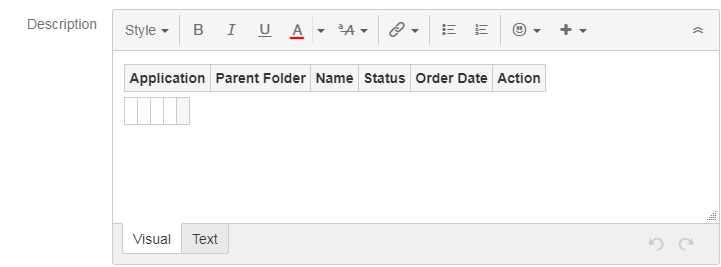

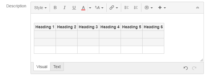

December 6, 2017
Divya Yathagiri Venkata
December 6, 2017
I tried that, pls see the results above
December 6, 2017
first is expected, second is actual
Ignacio Pulgar
December 6, 2017
May you click on the Text tab of the actual result to see its wiki notation?
Ignacio Pulgar
December 6, 2017
Try copying this in Text mode:
||column 1||column 2||column 3||
|cell value 1|cell value 2|cell value 3|
Ignacio Pulgar
December 6, 2017
I suspect you have one extra carriage return between both lines, which is causing the weird display of the table. Just remove the empty line between the column headers and the first row and the table will be displayed correctly.

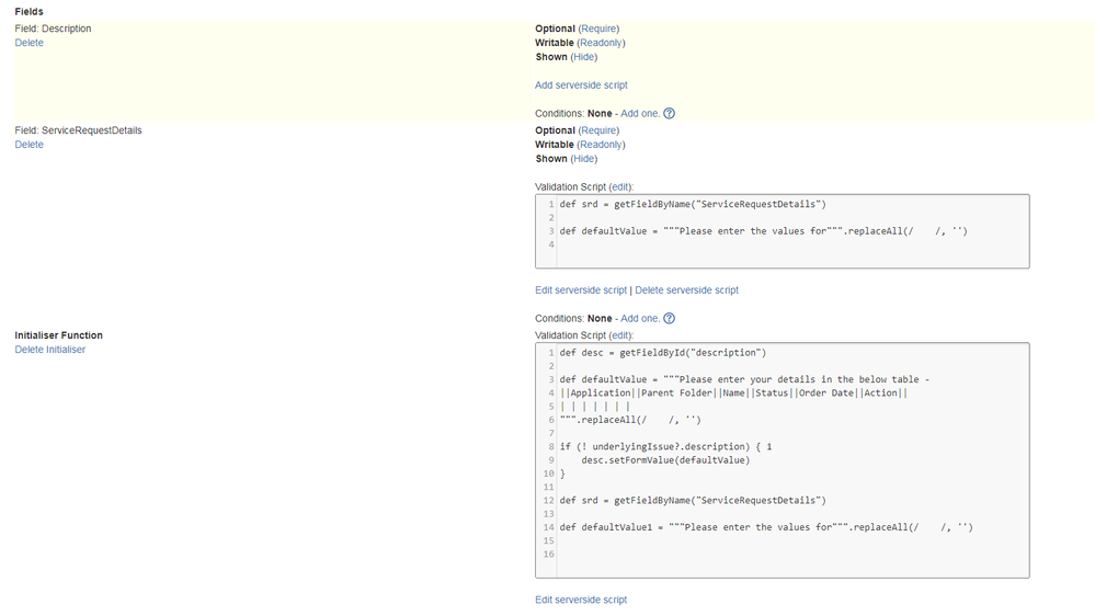

January 9, 2018
Yes, I did follow the steps in the link and it worked for description
Below is my script for a new custom field called ServiceRequestDetails
def srd = getFieldById("ServiceRequestDetails")
def defaultValue = """Please enter the values for""".replaceAll(/    /, '')
I mapped the behavior to the correct project and issue type. The ServiceRequestDetails field is seen on the screen but it is empty. This is a multi-line text field.

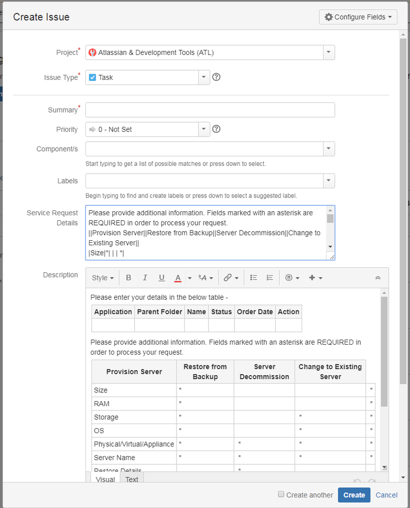

January 11, 2018
Ignacio Pulgar
January 12, 2018
Reviewing the docs for Description:
https://scriptrunner.adaptavist.com/latest/jira/behaviours-overview.html#_setting_a_default_description
There's no need to select the fields, as they are implicit in the code.
Perform the following actions, and try again after each of them:
  • remove the selection of both fields
  • (if the previous action do not work) add both codes to the same initialiser function
January 12, 2018
Yes, I have tried this earlier but with getFieldById instead of getFieldByName. So it didn't work earlier and it works now!
But looks like I have a problem displaying a table in the field. It must be a wiki renderer issue but am not able to fix that. The same script works for Description field and it shows a table but it doesn't display the table for the Service Request Details field. So issue is not with the script but with the field.
I've actually tried to put in a default value by configuring the custom field 'Service Request Details' itself. It worked it displayed table with content but it works intermittently - it doesn't display table and within few mins if I hit create issue button it again does display. The behavior script didn't even show the table once. Basically the Visual and Text tabs are not seen on the Service Request Details field unlike Description. Do you know how to turn that on?
