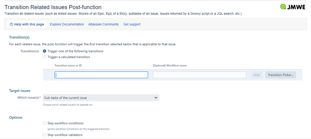

if you have JMWE, you can simply use a "Transition Related Issues" post-function, no scripting required.

In the Attached attachment could u please explain how the fields to be filled for  "Transition Related Issues" post-function,Transition PostFunction Steps1.PNG
David Fischer
March 11, 2022
Hi @Ravi Kanth ,
  • Under Transition(s), add the transition name or ID of the transition to trigger on Project2 issues (e.g. "Close Issue"). You can use the transition picker or just type the value
  • Target Issue(s): select "Issues linked to the current issue through the following link type:" and then, under Issue Link, select the link type direction that links Project 1 issues to Project2 issues
  • If the "Close Issue" transition of project2 has a transition screen, you might want to add the fields of that transition screen under the "Transition screen" configuration section to provide a value for those fields

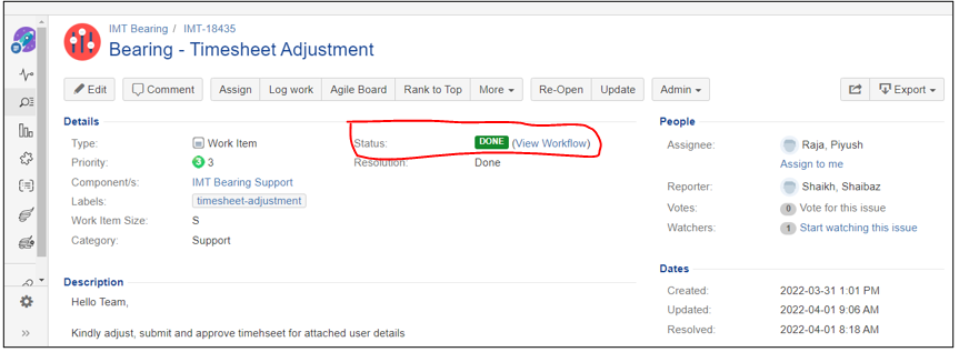

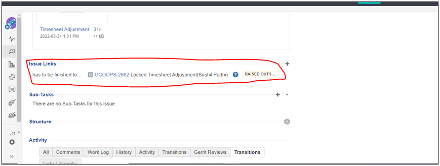

Hi David Fischer _Appfire_
Minor Change in requirement as suggested by the client that
We wish to create a linking structure between issues of mentioned Jira projects in such a manner that if a "IMT" project ticket status changed to "Done" from any other status, the "GCOOPS" project which is linked to "IMT" Project based on issue link type "has to be finished together" ticket should also automatically change the status to "Done" which is in currently "Raised Outside Project" Status.
Requesting guidance on how to make the above possible.Issue Linking1.PNGIssue Linking2.PNGIssue Linking3.PNG

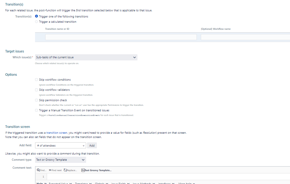

In the below Attached attachment could u please explain how the fields to be filled for  "Transition Related Issues" post-function,
David Fischer
April 6, 2022
Hi @[deleted]
  • Transition(s): add the transition name or ID of the transition that takes GCOOPS issues from the "Raised Outside Project" status to the "Done" status
  • Target issues: select "Issues linked to the current issue through the following link type:" and then select "has to be finished together" as the Link type

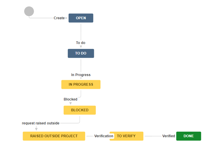

As per the attached screen adding the transition name or ID of the transition that takes GCOOPS issues from the "Raised Outside Project" status to the "Done" status is not possible as you can see in the screen that transition do not exists from the "Raised Outside Project" status to the "Done" status.Issue Linking WorkFlow.PNG
Is there any way to bypass the transition from the "Raised Outside Project" status to the "Done" status and status can be changed from "Raised Outside Project" to the "Done" to the linked issues
David Fischer
April 7, 2022
@[deleted]
The easiest is to add the missing transition and hide it from users by adding a "Hide from users (JMWE app)" condition on that transition. This way you'll be able to transition directly from Raised outside project to Done using the Transition Related Issues post-function, but users won't be able to.

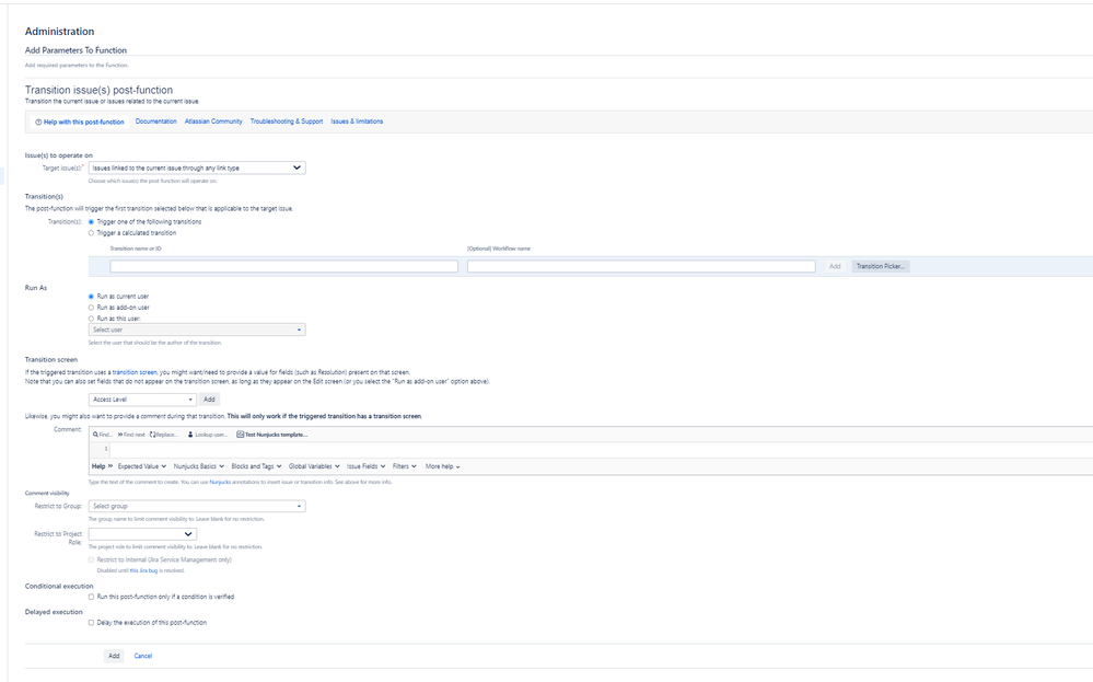

sekhar reddy
January 11, 2023
Hi @David Fischer
I am not seeing the option of Target Issues in this post-function. Could you please clarify on this. BTW I am using cloud version of JMWE plugin.
David Fischer
January 12, 2023
Hi @sekhar reddy ,
it's the first option at the top (in the "Issues to operate on" section).
