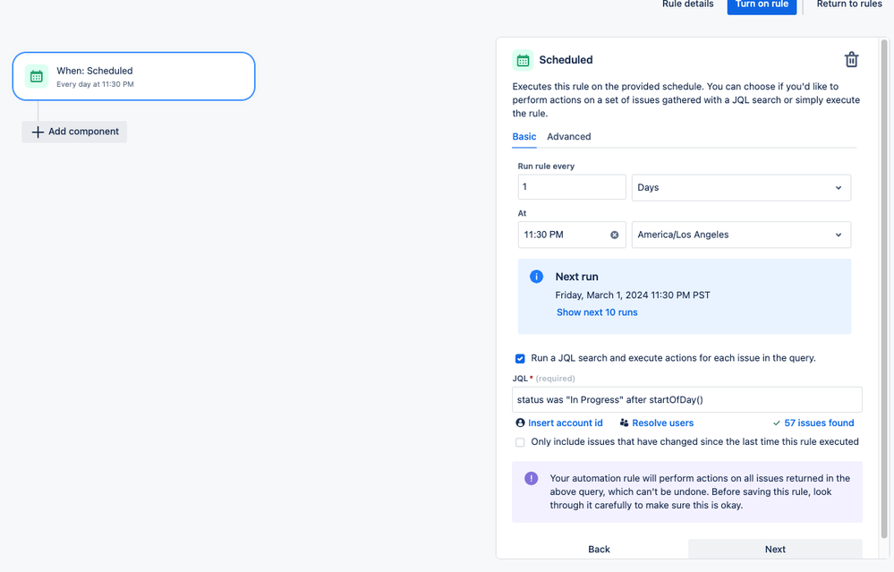

The trick with Automation will be figuring out how to trigger it to get the desired affect.
For logging time you might use a Scheduled Trigger to run once a day, towards the end of the day, and find all the issues that had a status of "In Progress" at some point on that day.
status was "In Progress" after startOfDay()
Using this JQL would ensure that if an issue moved to "In Progress" some time during the day and then to another status, it would still get work logged for that day.

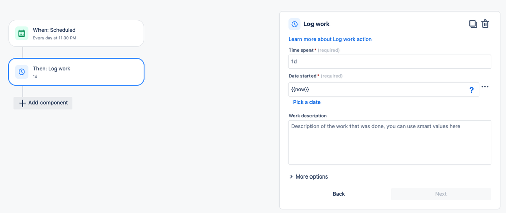

Then log 1d of work to each of those issues.
Screenshot 2024-03-01 at 11.24.35 AM.pngScreenshot 2024-03-01 at 11.26.46 AM.png
