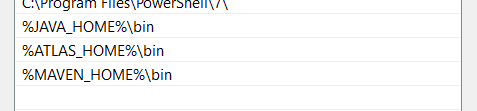

I also ensured I added the env vars as you suggested. I've only shown images for ATALS_HOME and MAVEN_HOME as the java install works as expected.
Any other suggestions would be gratefully received.

$ echo $PATH
/c/Program Files/PowerShell/7
/c/Program Files/Java/jdk1.8.0_361/bin
%ATLAS_HOME%/bin:%MAVEN_HOME%/bin
It's there. Pls note I separated the lines which are usually combined into a single line to make them easier to read
