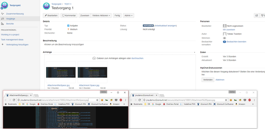

I am running Atlassian JIRA v7.4.0 behind nginx.
The issue is reproduced here:
https://drive.google.com/file/d/0BzoglGX2I_oxTE9XS2RhZll3VG8/view
There's nothing in the log-files :(

But here's also a screenshot:

Hmm.  I'm not sure what that might be.  The url looks correct, and there's no reason not to display it.  If it were an encoding or "file name wrong", I'd expect a browser error message.
I assume the files are the same, just with different names?  (Eliminates any chance of the file content causing a problem)
Does the blank screen have any html behind it at all?  Could you compare the "view source" in the browser for both views?

You can also have a look yourself:
The Instance is sample/demo Application anyway to reproduce this issue: TEST-1 in t2consult demo-jira
User: tester
Password: Test1+
The picture is the same, just the filename is different.
The Thumbnails are displayed correctly for both images.
In the console I can see:
Failed to load resource: the server responded with a status of 505 ()
