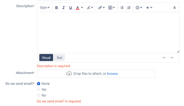

I would like to request that the Assignee fill in the three fields that I have included in the Validators. However, I have encountered a problem where two of the fields have become required, but the Attachment field has not.
Although there is a required sign (*) present, it does not seem to be functioning properly. This means that the Assignee is able to change the status without uploading anything, unlike the other two fields which are working correctly.

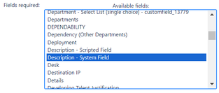

The Description and Do we send email? fields functioned correctly, but there was an issue with the Attachment filed.
Upon closer examination, I observed that while the Description and Attachment fields are both system-generated, the Description field is correctly labeled as such, whereas the Attachment field is not.
Here's an images to illustrate my point:

that's what I mean,
the status can change even if the assignee does not attach anything
but he can not change the status if he don't fill the Description and Do we send email? fields

As @John Funk suggested, you need to remove any Field Required validators for those fields on the transition. It looks like you have the Fields Required validator from JSU for the Attachment field. Please remove the validator and verify!
