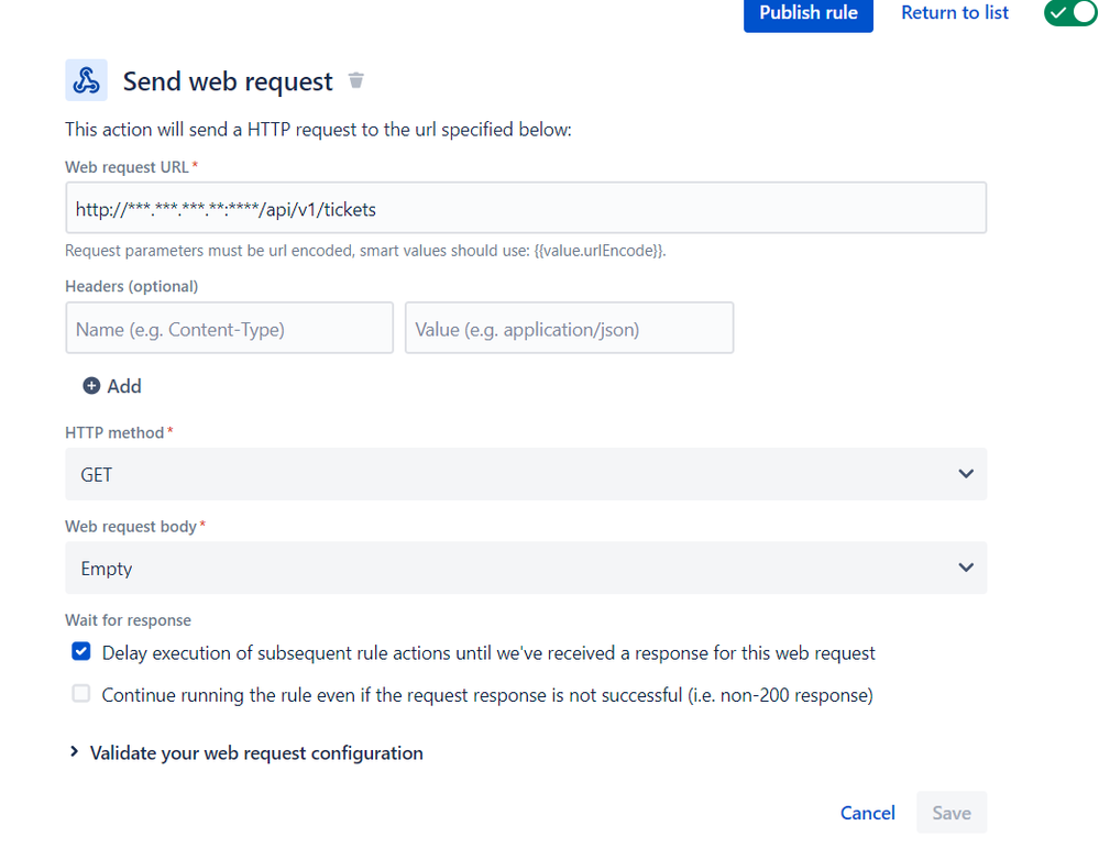

While Writing Automation Rule for my project the below error of 403 is showing in Jira
I have tried this API from another machine and it's working fine and I have also whitelisted Atlassian URLs on my remote VM.
Can Anyone Help ?

Hi @[deleted] ,
Yes I am using raw IP where my project has been hosted.
I need an API call to http://***.***.***.***:port/api/v1/tickets when status is changed
so I am using web request URL but getting above error.

Looking at the response body, it seems that the issue is not so much not being able to locate the url/server, but that the request is being denied due to not being authorised (hence the 403 response code).
I am not sure what hosting infrastructure you have set up to grant public web access to your hosted VM, but it appears is is proxying via squid web proxy. This may be used by your hosting provider, and may indicate our servers are unauthorized to access your API?
With your successful request from other machines, are there any authorization headers you provide when making the request?
