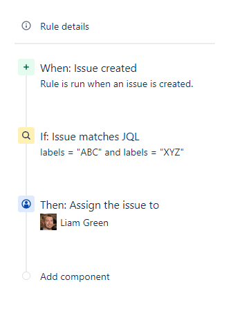

Liam Green
August 9, 2021
Hi @Marcel Gunst
Welcome to the Community!
This would be difficult to achieve if you have a lot of potential labels, but the below is the basic rule you would need
Hope that helps,
