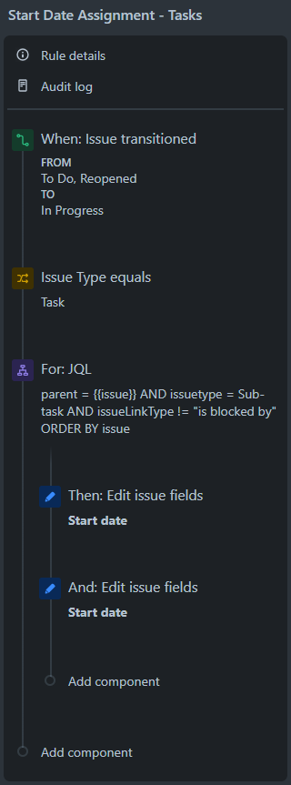

1. Parent: When Issue transitioned to "In Progress" -> For each unblocked issue > Unset and then Set the Start date to the TriggerIssue.Start Date (customfield_xxxxx)

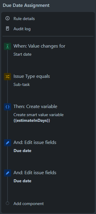

2. Sub-tasks: When the field "Start Date" value added -> I calculate the Original Estimate in business days and then add it to Start Date. Then unset and set Due Date to the final value.

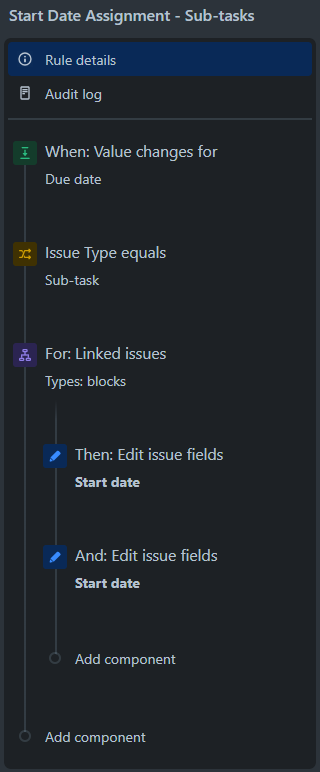

3. Sub-tasks: When the field "Due Date" value added -> For each blocked issue in the Issue Links > Set the "Start Date" to TriggerIssue.Due Date + 1 Business Day.

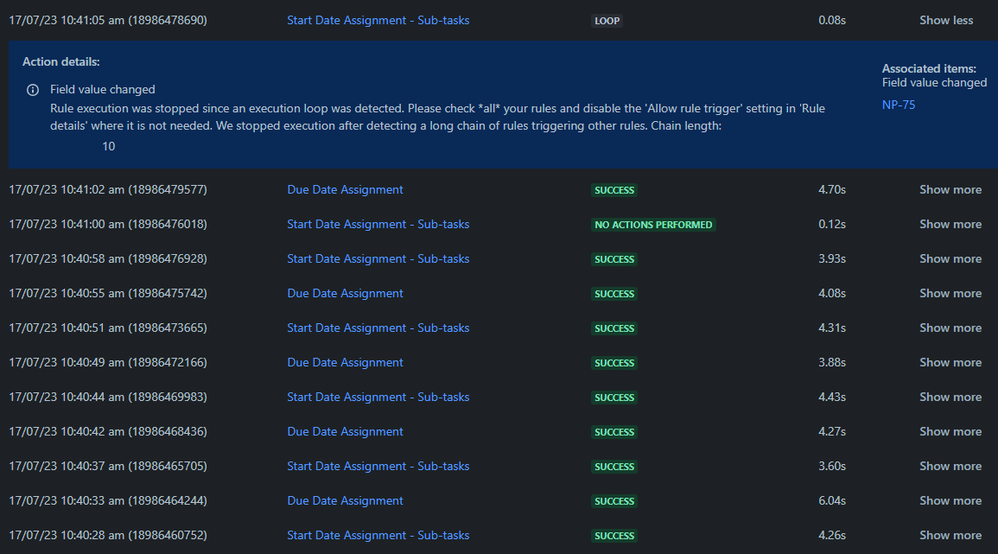

I have 16 sub-tasks to run through and as I mentioned, I get a loop error once it hits 10 recursion. The sub-tasks are NP-70 through NP-85:

Regardless of user tier Automations are limited to 10 recursive triggers. That information is in this document:
https://support.atlassian.com/cloud-automation/docs/automation-service-limits/
