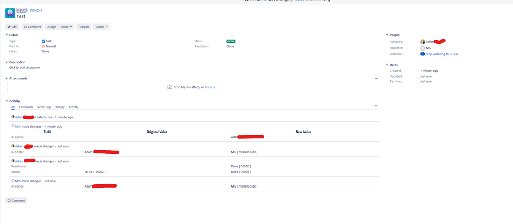

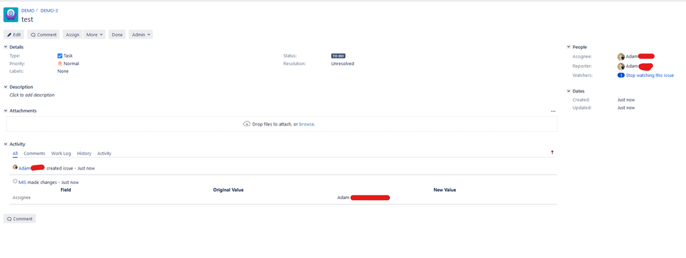

In both cases, this script post-function is set as the last post-function in the transition. Here is what happens when I create a ticket with myself as the reporter, and then change the reporter back to the user mishelpdesk
Notice that in the issue history, the ticket is reassigned to mishelpdesk, but this does not persist or actually take place. However, if I execute the same function in the script console as opposed to the workflow, it works as intended.
Any idea why this would work in the create transition but not subsequent ones?

I didn't spot any obvious issue in your script.
It looks like the assignee is changed in the issue history but for some reason the re-index didn't happen for this issue.
  • Can you run a re-index in the project and see if the assignee changes to mishelpdesk? This will help us to understand if you are having an index issue. Reading the JAVA Doc, IssueService.assign() does re-index the issue after the update, and it's strange that it did work when you created the issue but it didn't work on your transition to Done.
