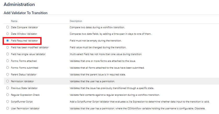

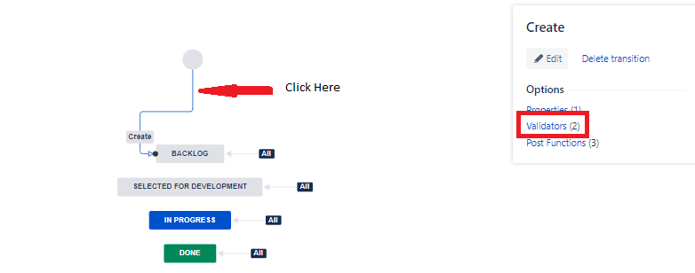

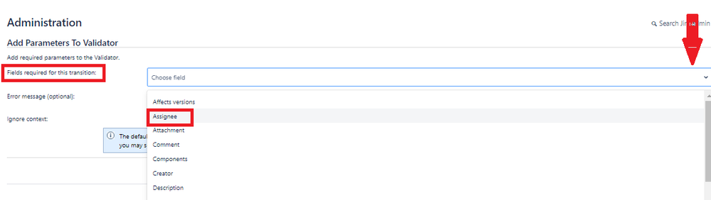

You can make the assignee field mandatory so that no one can create the ticket with assignee as "unassigned".

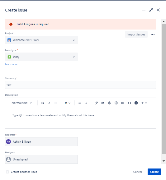

Below is the screenshot for your reference of the validator that you can use:
after this one will see the message "Field Assignee is required." if assignee field have the unassigned during the issue creation:
