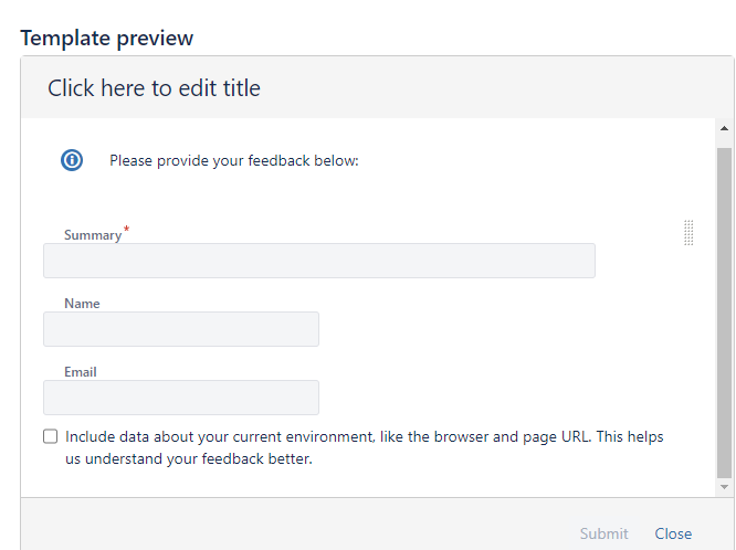

Hi Atlassian Community,
I am trying to extract the "Name" field (as illustrated in the picture below) to smart value so that I can use in Automation Rule. To be more specific, I'm trying to send email to a team leader informing him/her that the person in the "Name" field is requesting to access a system.
But I can't seem to find it after reading through the guides. My assumptions are:
1. This is a custom field and only administrator can call it.
2. I might need to dig deeper.
Either way, please enlighten me on the solution and be in touch.
Thank you,
John

Thank you Jack,
I totally comprehend your explanation. However, let me elaborate more on this matter:Screenshot 2022-03-31 135253.png
As you can see in this picture, the email value can be extracted using {{issue.description.substringBetween("mailto:","]")}}
The reason I know this is because the value was passed on to me at work but I don't know how did this arrive as a solution.
What I need at the moment is to do the same with the "Name" field.
John To
March 30, 2022
oh I figured it out by the way
{{issue.description.substringBetween("*Reporter*:","\n")}}
