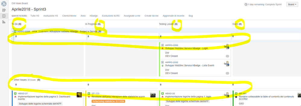

I have configured several agile boards. They all work correctly except 1, which is also the DEV MAIN Board. Io ho riscontrato il problema since yesterday:
When the board is loaded, an additional ajax call is also started. At the end of this, for each column of the board, they are shown the new values ​​"(0)" that were not present on the board before

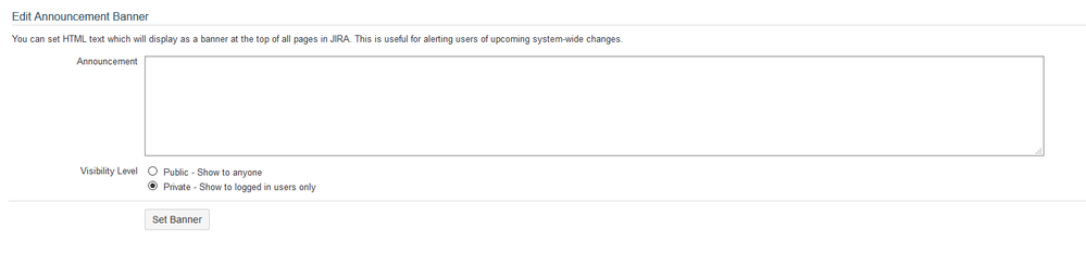

I would also check the Announcement banner in Jira to see if this contains any scripts as well.

I enclose the board screen image.

I attach the configuration screen of the Announcement banner (no script configured)
I find the problem on both Chrome, Firefox and IE

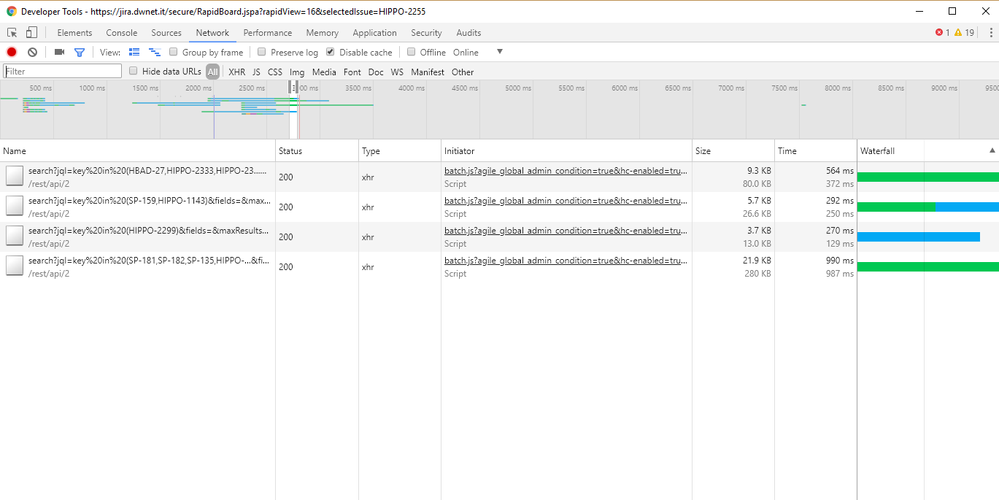

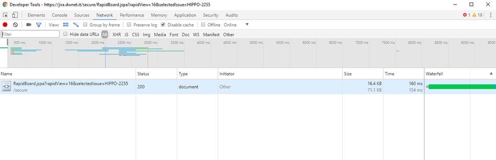

Meanwhile, I forward you:
the first major call when the board loads.
Once the board is loaded, there are 4 additional calls which are the ones that make the "(0)" appear.
I'm disabling the plugins one at a time, but the presence of the "(0)" persists. It is strange that the other boards, equally configured, are not affected by this problem.
