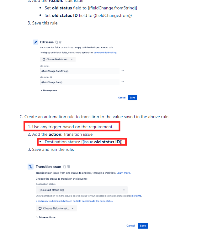

Hi @Christopher Carvalho, welcome to the community!
You can find an exact use case in the Atlassian documentation below. Essentially, you will use Automation for Jira to execute the updates: https://confluence.atlassian.com/jirakb/how-to-transition-to-the-previous-status-of-an-issue-using-automation-rules-in-jira-1236599919.html
I hope this helps.

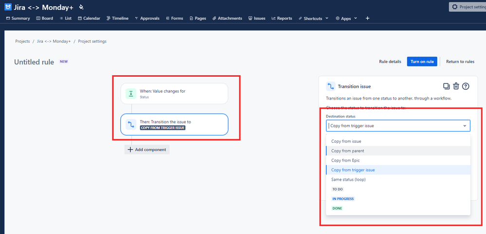

However, I got lost at this step of the process:
What does it mean to use any trigger based on the requirement? Which requirement?
I just tried to set it using status change as a trigger, not sure if that's what it meant...
Then, when trying to add "{{issue.old status ID}}", the tool doesn't give me this option even though I already set the rule from the steps before this
This is how the rule I built with the first steps looks like:
Care to share further details here?
