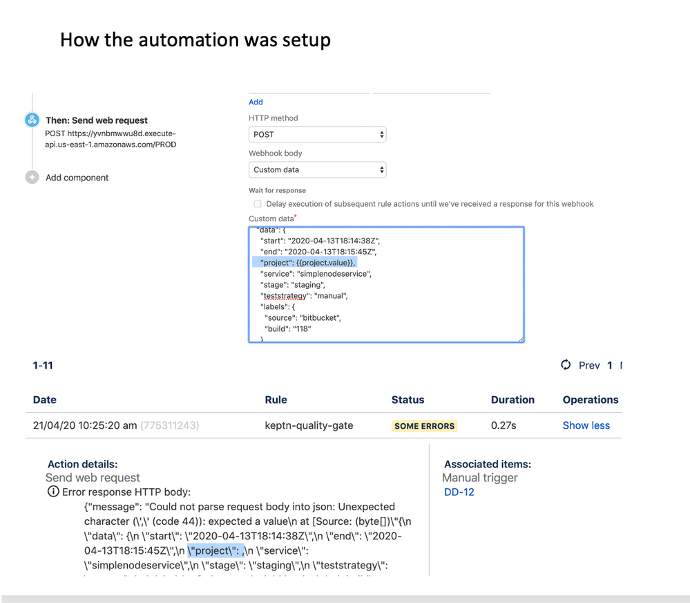

I would like to be able to use smart values (https://support.atlassian.com/jira-software-cloud/docs/find-the-smart-value-for-a-field/) ... In the custom data for the automation. Is this possible?

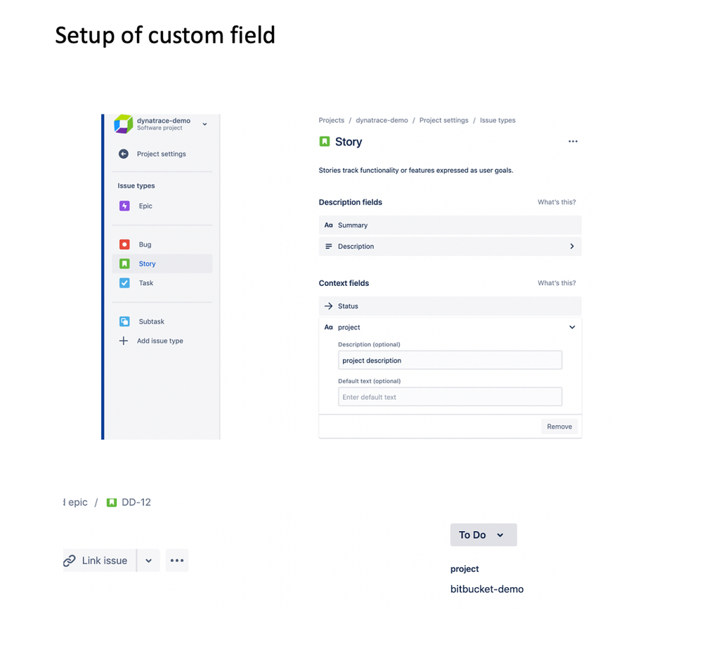

For example I add project, service, stage custom context fields to a story, and then I want to refer to them in the POST custom data setup for the 'Send web request' automation component.
"project": {{project.value}},
"service": {{service.value}},
"stage": {{stage.value}}

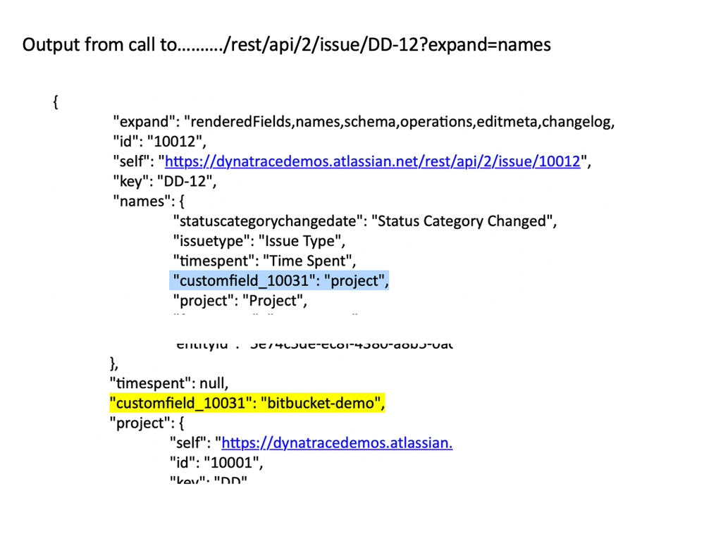

Well I did make a new field (called project in this example)and tried a few ways to reference it in the post body
{{project}}
{{project.value}}
{{customfield_10031}}
{{customfield_10031.value}}
When I look at the automation audit log, the value for this field is not getting resolved. Perhaps I am not using the right syntax?
attached are a few pics.
