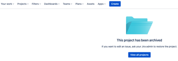

It does affect boards located within the project, and here is an example:
In the Charley project there are two boards
After the project has been archived non of these boards are visible if you search for them and if you access the direct link to them this is what you will see
