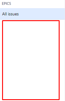

When using the epic link JQL function, the board correctly filters the Epics I would like to see, however, the epics panel on the left hand side is visible, however there are no Epics listed. Which is....kind of backwards.
There should be a function where you can filter only certain Epics into a board, but then still be able to see them in the panel, that way you can edit and filter during discussions and planning more efficiently. Obviously I could create quick filters but that seems overkill.

I should definitely clarify actually, I do not want to JUST look at Epics in the board. I want to see:
- Certain Epics as per my filter
- All issues associated to those Epics
- Still be able to see the Epics in the Epic Panel

Hello! I have two boards. Both are agile scrum and both are in the same project.
There are some Epics I do not need to display on one board, and vice versa.
