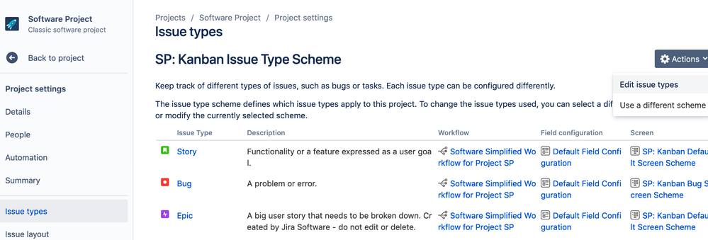

Let's start with the issue type scheme. The easiest way to modify the issue type scheme is to navigate to Project settings > Issue types > Actions  Edit issue types.
Just drag the Request issue type into your list and save. This should add the issue type to your project without impacting the existing issues.

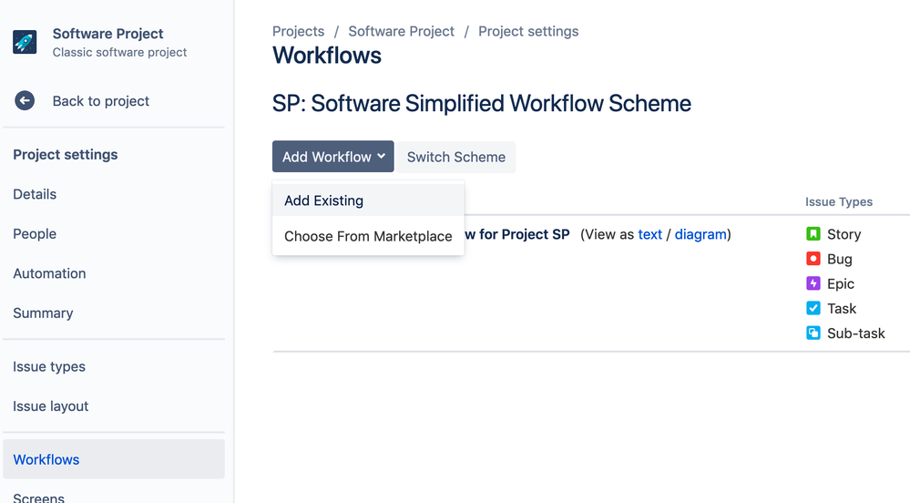

Again, the easiest way to do this is to modify the existing one rather than creating a new scheme and applying it. Head to Project settings > Workflows > Add Workflow > Add existing.
Pick the workflow you made for the request workflow and then click Next. Check the box to your Request issue type and click on Finish. After that, you can publish your draft.
