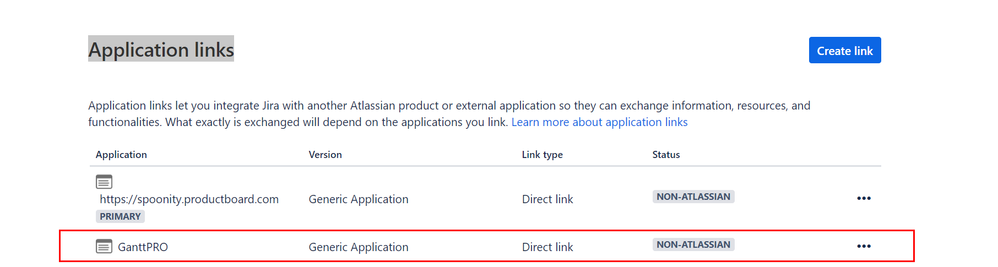

Hi just setup an additional application link for another tool, but does not seem to be working.
I´m not able to set it as "PRIMARY" as I already have 3 others as PRIMARY. Could this be preventing for the 4rth one I added to work?

hi, so I successfully connected Jira with Gantpro. I see it listed in the application links tab. But If I try to execute the connection, nothing happens. I'm wondering if it requires a mandatory thing to be set as "Primary"? Do you know if this could be a potential issue?
I´m not able to set it as "PRIMARY" as I already have 3 others as PRIMARY. Could this be preventing the 4rth one I added to work properly?

Can you provide a screen image of the application Links screen?
What steps are you executing when you say you are "executing the connection"? Can you provide screen images for that?

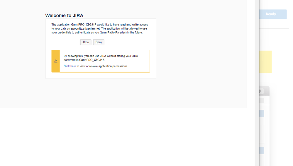

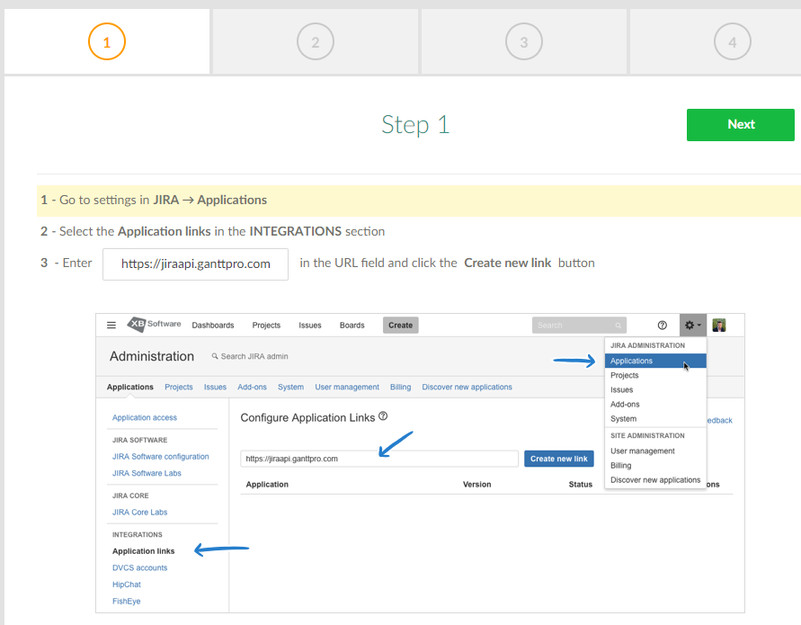

JuanPablo
May 20, 2023

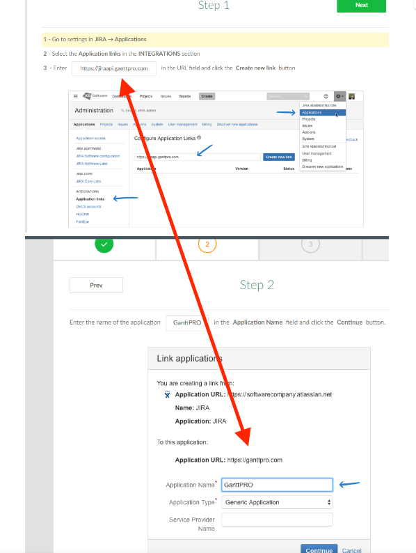

On Jira followed this steps: https://help.ganttpro.com/hc/en-us/articles/360020656197-How-to-set-up-integration-with-JIRA-

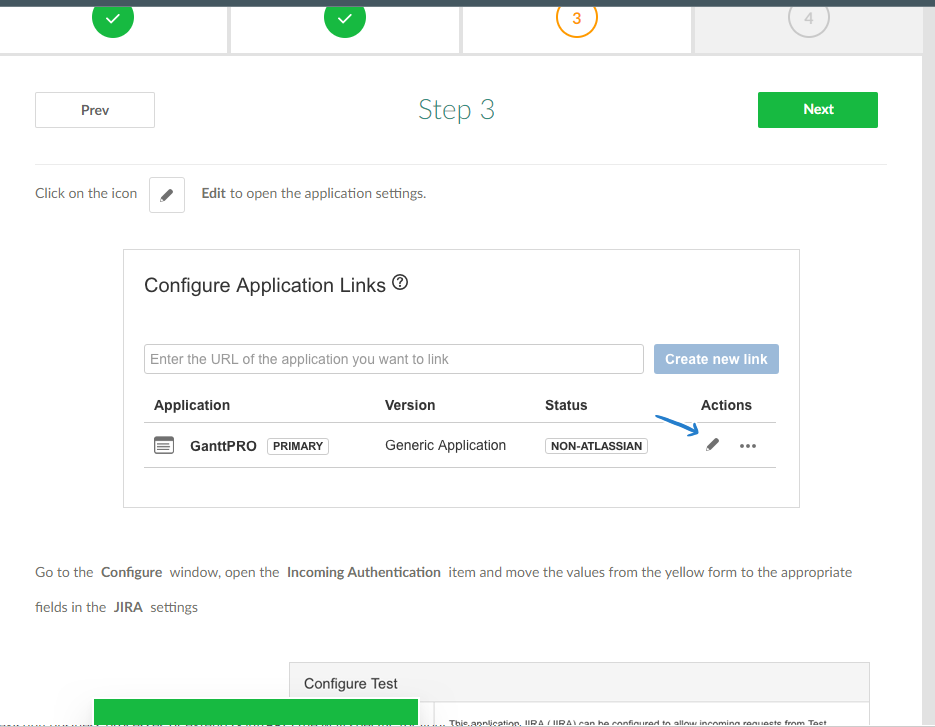

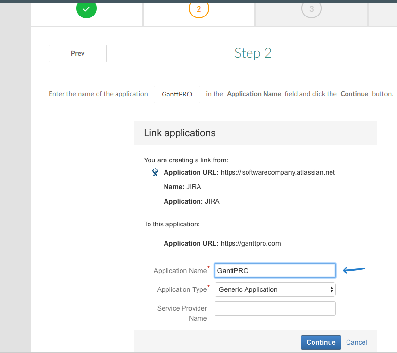

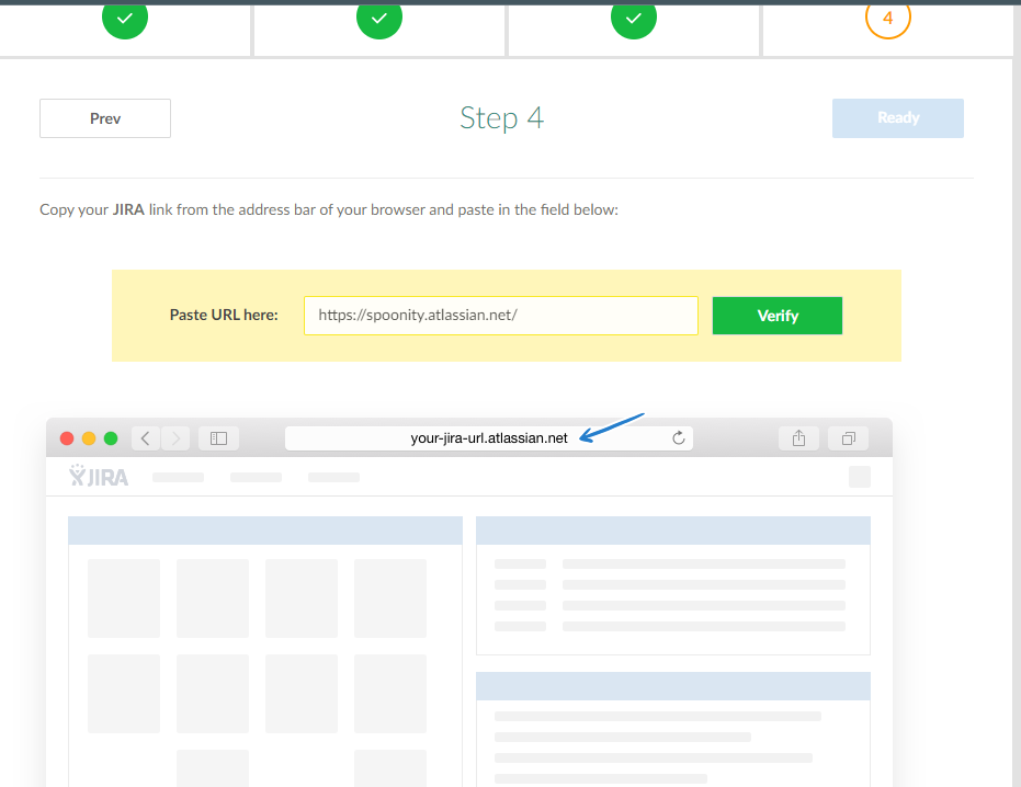

And these are the steps in ganttpro (see 5 step attachments please)
once I click "allow in step 5" nothing happens, ganttpro doesnt show it like "connected"application links.pngstep 1.pngstep 2.pngstep 3.pngstep 4.pngstep5.png

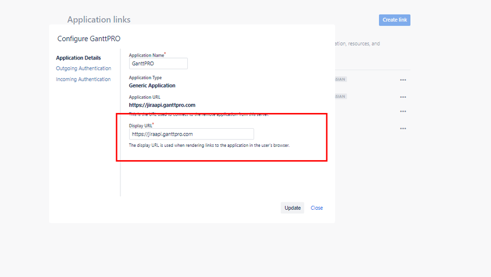

Trudy Claspill
May 20, 2023
Based on the document link you provided, you put in the wrong URL for GanttPro in step 4.
The document says to enter https://jiraapi.ganttpro.com.
Your image shows https://ganttpro.com.

JuanPablo
May 21, 2023
Hi, so that image is from Gantpro but appears it's outdated. I followed the document and did put the right one.
not sure if it's a Ganttpro issue. I´ll follow up with their support team.

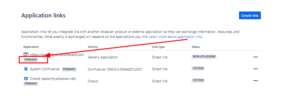

in application links, there´s a maximum of 3 applications to be set as "PRIMARY"? (attached image)
If got from ganttPRO that the application link needs to be labeled with "PRIMARY", but If I set it as primary, it will take away the label from other of the applications I have set as PRIMARY.
Let me know your comments please.
Trudy Claspill
May 24, 2023
According to the documentation:
"Make primary – specify a default instance if you have multiple links to the same type of application (for example, to multiple Jira servers)."
I do not know for sure, but I would guess that you can have only one link that says "Generic Application" set as primary.
