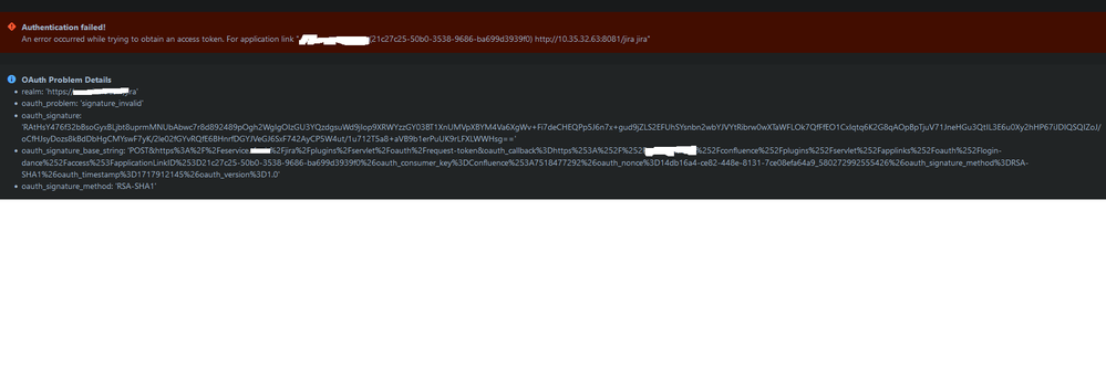

  1. Oauth Problem.pngwhat wrong with this config ?? (my jira and confluence are both working fine behind reverse proxy this issue only for application link between them)

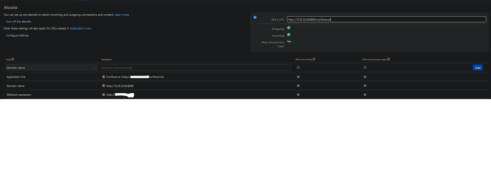

this issue related to my reverse proxy that not create access token from jira to confluence and confluence to jira !! i added jira in confluence allow list and confluence to jira allow list and everything is fine! but i think reverse proxy doesn't allow call_back oauth request. allowlist.png

i must used internal jira (confluence) ip address with connector port for connection establish. but after that in application link status i face with network error that say possible your server behind misconfigured reverse proxy!! (my nginx reverse proxy config has been available in post 1) and when i want access to jira frrom confluence i face with error OAuth Authentication failed !! (attachment picture 1 ) , i think this issue related to my reverse proxy config !!
