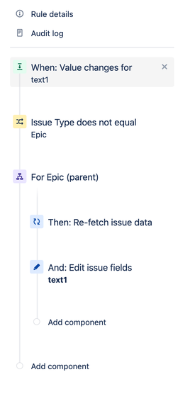

I think that is what you are trying to avoid.  So if you do not want this rule to run against Epics, then you can add in a condition before your branch in the automation rule.  For example, I created this one:
This condition uses an "Issue Fields condition" to see if the issue type does not equal Epic.  This way your rule can still run against other issue types, but won't be run against Epics themselves.
Does this help?  Let me know if this works for you, or if I have misunderstood the desired actions here within automation.

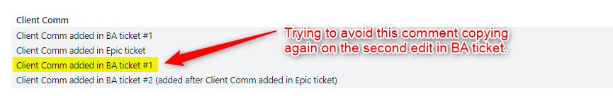

I have the Edit issue set as below. It is my understanding that the changelog should only copy the changed values. However, it is copying the full value from the story if the field has previously been modified in the Epic.
{{issue.Client Comm}}
{{#changelog.Client Comm}}{{toString}}{{/changelog.Client Comm}}
If we only ever add values to the story tickets in this field then the automation will work perfectly. It's when a value is added directly to the epic in this field that the automation breaks and copies the full value of the story field the next time it is modified rather than only copying the modified value.

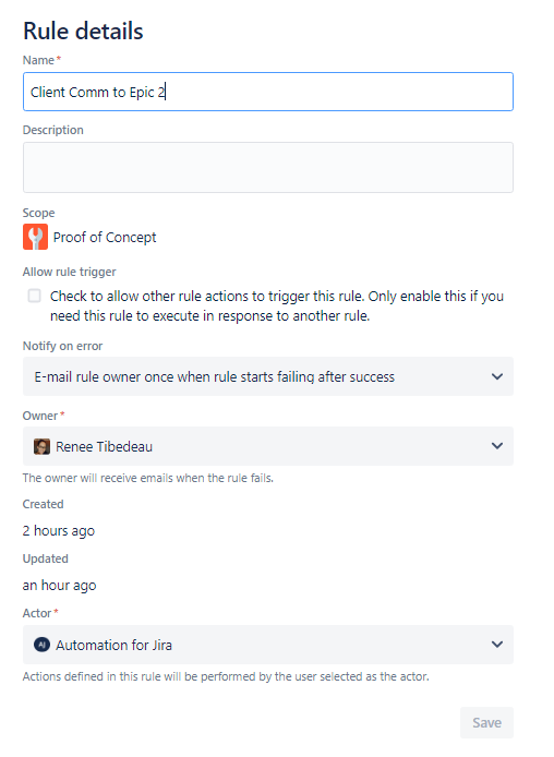

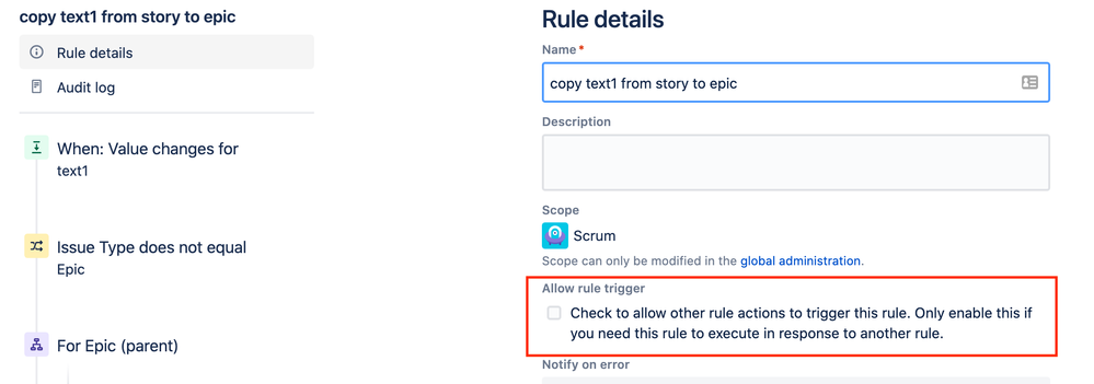

Thanks for the additional info Renee.  I tried to setup my own project with the same kind of rule, but so far I have not been able to reproduce your behavior here.  I think I'm missing something here.  Could you go back to the automation rule in question, and then click the Rule details?  I'm curious if perhaps your rule has the "Allow rule trigger" enabled:
If you have this enabled, it certainly could be that some other rule is making changes to multiple issues at once.  I can see a scenario where if some other rule triggers this one for more than one issue in the epic at roughly the same time, what can happen is a race condition where both issues try to update the epic at the same time.  So first issue does a lookup of the current value for that field in the epic at the same time as the other issue does the same thing, but since the first issue updated first, the second issue doesn't make a second check of the previous value and just updates the issue with what it believes was the previous value.

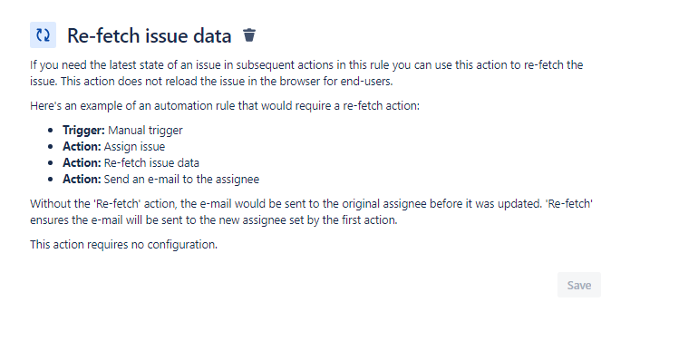

Checking the audit log of the automation rule could probably give us more details about what is exactly happening here.  It might be this scenario I described here.  One thing you can try to do to avoid this problem is force the automation to do a lookup of the issue value before setting the value. This action is called "Re-fetch issue data".
With this action happening immediately before the edit, automation should then have a more accurate understanding of what the current value of {{issue.Client Comm}} actually is at the time this rule runs.
Try this, even if your rule is not using the "Allow rule trigger" enabled here, it is worth trying this adjustment to better understand if the cause of this is multiple issues running this automation at nearly the same time.  If this doesn't correct the problem, I would be interested to take a closer look at the audit log of this automation rule to see in more detail what values are being set by each execution of this rule in sequence.
