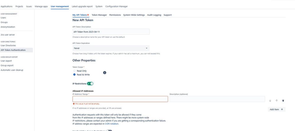

hi ! @Gopi Ramamoorthy . Please try following:
1. Disable basic authentication for API calls: https://confluence.atlassian.com/enterprise/disabling-basic-authentication-1044776464.html
2. Setup token authentication with IP restrictions:

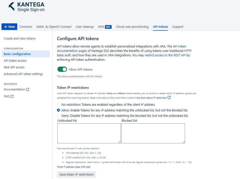

You can also use some advanced plugins like Kantega:
Trudy P Claspill
April 12, 2025
Hello @Piotr Witka
Your screen image for My API Token is from a self-hosted (i.e. Data Center) Jira Product.
The author of the post specified Cloud as their Deployment. That is the Atlassian-hosted SaaS products.
Your information does not apply to the Cloud/SaaS product.
