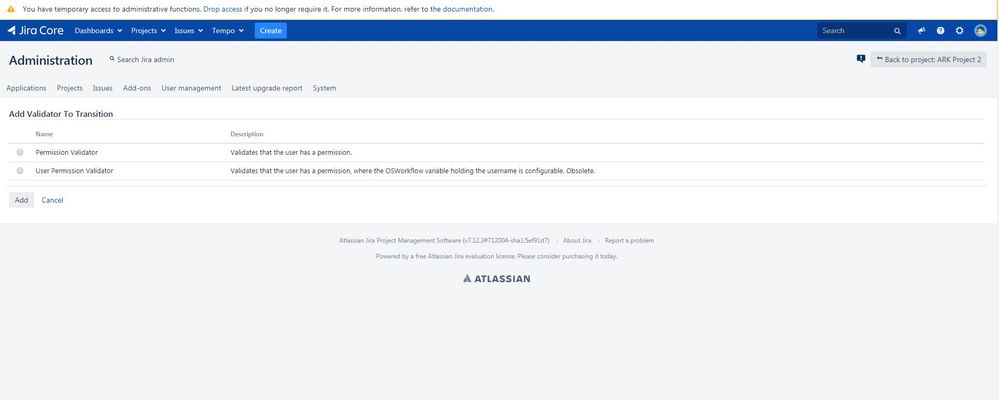

Hi Sreenivasaraju,
Thank you for your response .... But I am not able to get the option of adding comment validatorValidator.JPG
