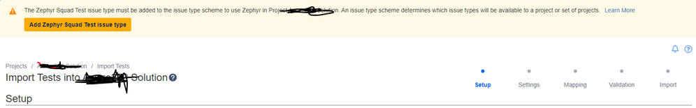

Although i have the test type in my issue type scheme, i still got the error "The Zephyr Squad Test issue type must be added to the issue type scheme to use Zephyr in Project .."

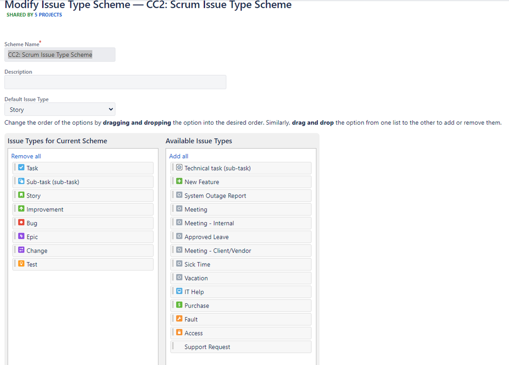

Looking at you screenshot of an issue type scheme on you cloud, I don't see the Zephyr Squad issue types.
These are added as issue types in the system, when Zephyr Squad is installed as an app.
Zephyr Squad is not working when not installed, juts adding an issue type Test in your system, will make you able to use it.

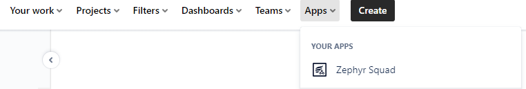

The app is installed and we can create an issue with the type "Test" using the Create icon on the main jira screen. When we go to Zephyr screens via Apps-> Zephyr squad, it is not working. Please note that , when we first intsalled Zephyr, there were two Test issue types . We deleted one of these instances.
