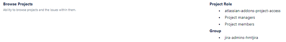

I have a project in Jira Cloud, called e.g. JIRA Test in which only members belonging to the groups "Project Manager" and "Project Users" can create/edit and view issues within the project. This was achieved by creating a permission scheme in which almost all fields such as "Browse Projects" field was restricted to the above-mentioned members only, as you can see in the image below.
No one else within the organization has permissions to see/edit what is in this project.

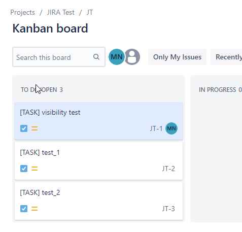

2- I created another group called "Project involved users". I assigned "Browse Projects" permissions to this group and kept the Issue Security Schemes as before. In this case the user in this group can see all the issues in the project and not just the ones assigned to him. Which I do not want.
In the picture below the MN user is assigned to the [Task] visibility test but as you can see he can also see tasks that are not assigned to him.

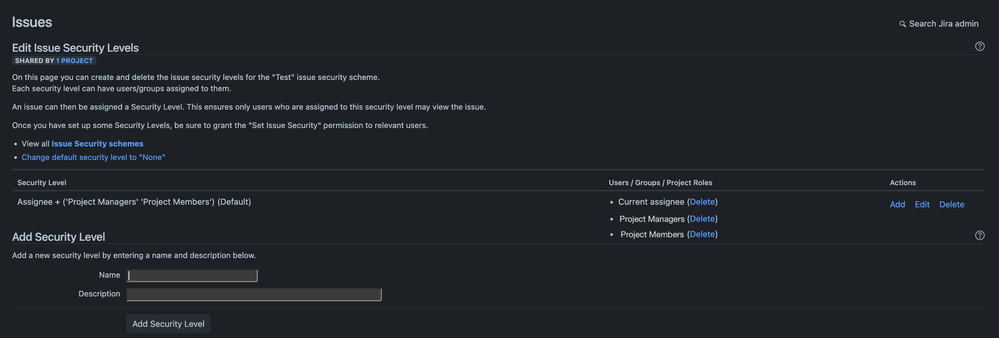

1. Set up all user roles ('Project Managers', 'Project Members', and 'other users') with basic access permissions. This includes 'Browse Projects', 'Assignable User', and others as per your project requirements. We'll restrict the 'other users' using security levels, not permissions.
Security Levels
Now, for the security levels, we want to ensure that 'Project Managers' and 'Project Members' can see all issues, while 'other users' can only see the issues assigned to them. Here's how you can do that:
1. Create a new Issue Security Scheme if you don't have one already. Within this scheme, create a Security Level.
2. For this Security Level, add 'Project Managers' and 'Project Members'. Also, add 'Current Assignee'.
3. Set this new Security Level as the 'default' for the Issue Security Scheme.
By doing this, both 'Project Managers' and 'Project Members' will be able to view all issues within the project, thanks to their inclusion in the Security Level. The 'Current Assignee' addition ensures that 'other users', when assigned an issue, can view their respective tasks. The 'default' setting ensures that every new issue created follows these rules, preserving the intended visibility and access control.
Ensure you assign this new Issue Security Scheme to your project.
Remember to test these settings thoroughly to confirm they're working as intended. Check different scenarios with different users to ensure everyone has the correct level of access.
Note: if you want this for all existing issues, make sure sure you transition them to the new security level

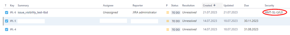

The reason why it didn't seem to work to me is that the old issues in the project don't automatically get the new security level set.
This is confirmed by the image below:
The permissions can be changed by doing a "Bulk change" --> Edit Issues --> Change Security Level and in the drop-down menu choose the desired Issue Security Schemes
