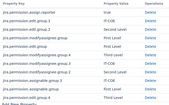

Hi @[deleted] - I missed that you mentioned it already. Interestingly this is working fine for me. Where did you add the property? on the status or transition?
Deleted user
October 7, 2020
@Niranjan
I send you a screenshot of my status properties: All are working only the "....reporter = true" is not working. Maybe I#m missing some interferences with the other properties so that's why it is not working?
EDIT: It seems the jira.permission.assign.* is generally not working (I also tried .group = jira-administrators, .user = adminuser and no option works)
Deleted user
October 8, 2020
Worked in another project seems to be some conflict in that special project
