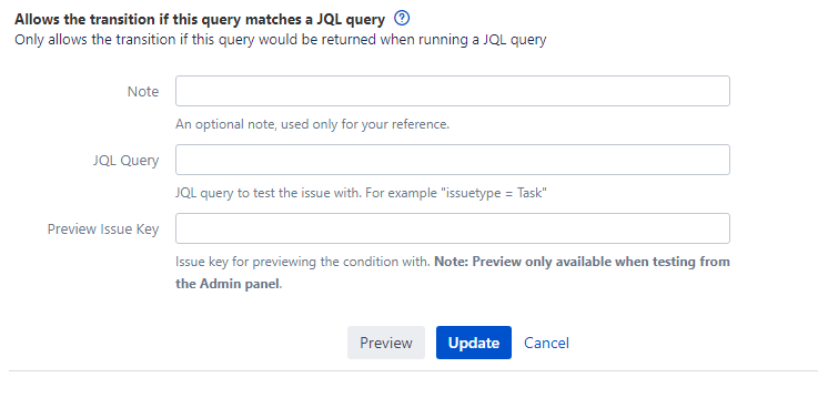

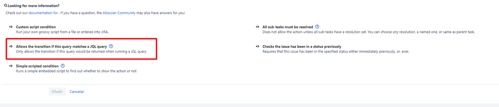

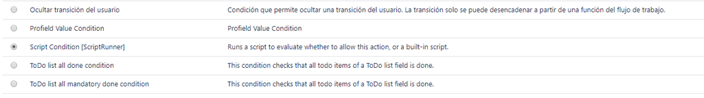

That option is available with JSU and with scriptrunner
1.
Bogdan Gorka
October 1, 2019
Thanks for your screenshots, especially number 2. I admit I have always overlooked that one. The investigation is getting exciting and here are my results.

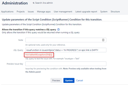

Yes Fran, at last with your help I found the working solution.
When I simply copied and pasted your last JQL query, this was the result:
But then I realized that the proper query should have quotation marks (which were missing also in the first JQL query)
So, I implemented the following solution:
issueFunction in issuesInEpics("statusCategory = 'In Progress'") AND "Epic Link" is not EMPTY
I tested it and it WORKS! Only when a story is linked with an Epic AND when it is linked with an Epic which is In Progress category status, the transition button for the Story will appear.
Great stuff! Thanks again for your help!

if you have scriptrunner there is a JQL function:
issueFunction in epicsOf("status= In Progress")
You can create a scriptrunner condition of type "Allows the transition if this query matches a JQL query"
