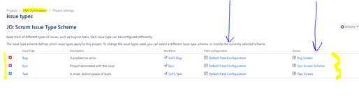

As you can see this is an issue when you need specific fields ONLY on certain issue types and to make them required:
We NEED absolutely NEED to have each issue assigned to a specific field configuration.  You can see we have created specific screen scheme for each and need the field configuration to be different as well.

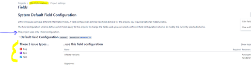

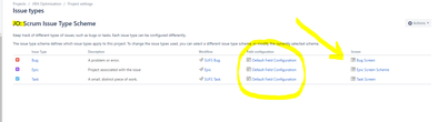

I think the issue is that all issue types have been set as default when the project was configured. Right now we are using Epic, Bug and Task.
They each need a different field configuration.  However when we try to change the FC scheme , it allows me to change Bug to the Bug field config:
However, when I try to change the task issue, it moves the bug issue type back to default:

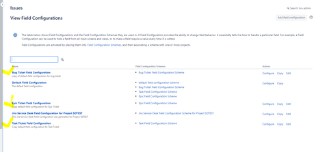

  • Go to the global admin area for issues (cog at the top right, issues)
  • Go to "field configurations" and check you have the ones you want to use (add more if you need)

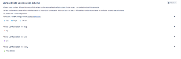

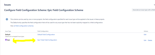

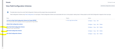

  • Then go to "field configuration schemes" and add a new one
  • Edit that "field configuration scheme" and associate each issue type with the "field configuration" you want it to have
BUG:
EPIC:
TASK:

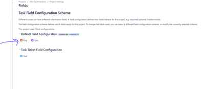

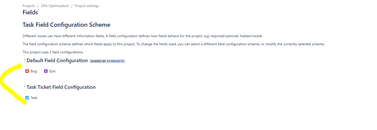

  • Go to the project and select the new "field configuration scheme"

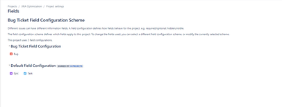

Project uses the same FC scheme for the 3 issue types:

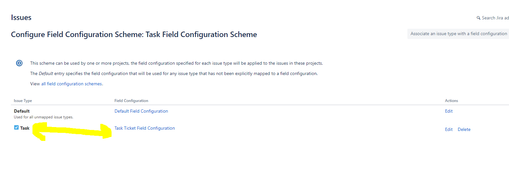

when I try to associate a issue type I am only allowed to change one the other 2 remain in default.  Change scheme for bug to bug fc scheme as you select a scheme then it is assigned to the issue ( I believe this is where the issue is?)
Shows Bug Issue with correct bug FC: other 2 issues types are still in default:
  If I attempt to change another it removes the prior one I change and sets it back to default change task to task FC: MOVES BUG back to default???

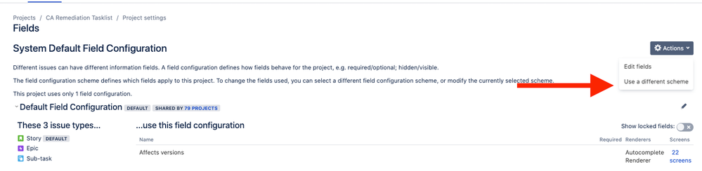

  • Now go back to the project admin and go for "fields".  Do not amend the body of this, use the "Actions" towards the top right and hit "use a different scheme" - from there select "my new FCS"
  • After selecting the new scheme, you should return back to that screen, where you should see your three issue types listed as having different field configurations.

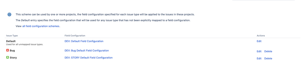

I think I see where you went wrong.
A project can have only one "Field Configuration Scheme" associated with it.
Within a Field Configuration Scheme you can have multiple issue types. Each issue type gets associated with a Field Configuration.
Notice the difference - Field Configuration vs. Field Configuration Scheme.
Looking at the screens you provided for this step:
"Edit that "field configuration scheme" and associate each issue type with the "field configuration" you want it to have"
...what you did was create 3 Field Configuration Schemes; one for each type of issue. What you need to do is create ONE Field Configuration Scheme, and in it add each type of issue with its associated Field Configuration. You must also have a default Field Configuration defined in the Field Configuration Scheme. The default Field Configuration will be used for any issue type that is not otherwise explicitly called out in the Scheme to be associated with a particular Field Configuration.

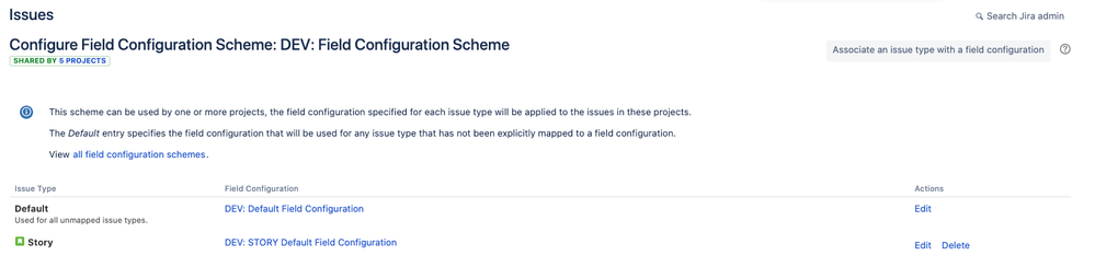

Here's an example of a Field Configuration Scheme that serves different Field Configurations depending on the type of issue.
The Story issue type uses the "DEV: STORY Default Field Configuration" field configuration.
Any other issue type available in the project will use the "DEV: Default Field Configuration" field configuration.
To add more issue types and associate each one with a particular Field Configuration, click on the button in the upper right labeled "Associate an issue type with a field configuration". That will pop open a dialog where you select the issue type (i.e. Bug) and the Field Configuration to associate with that issue type.
Here I've added the Bug issue type
Screen Shot 2020-08-21 at 2.06.27 PM.pngOnce you have all the issue types you want and their associated field configuration, plus a Default field configuration, in your Field Configuration Scheme, then you go to your Project Settings, select Fields, and use the Action button to access the Use A Different Scheme option.
Through that you select the new Field Configuration Scheme you created.

4. Goto your project --> Project settings --> Fields --> Actions --> Use a different scheme --> Add your newly create field configuration scheme.

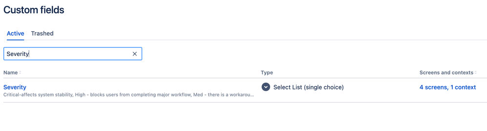

I have the same default config issue while adding custom fields for the specific issue type. I solved it by editing Applicable contexts for scheme. Listing the steps here in case it might still be helpful for you.
1. Go to your custom field and click context link in Screens and contexts column
2. Click Edit Configuration link next to Applicable contexts.
3. You will be able to pick and choose projects and issue types you want this custom field appear on.
