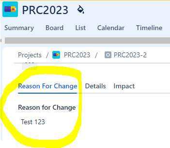

After Migrating to cloud / fields are not editable
Arvind Swarnkar
March 17, 2024
After Migrating from server to cloud / fields are not editable

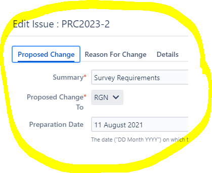

where as on jira server its editable see here

Hi @Arvind Swarnkar
Those are two different tabs aren't they?
It doesn't look like the tab is there in Cloud - but that might mean it's the "general" tab.
In Cloud, the tabs work as follows...
  • Tab 1: This is the "general" field tab - these fields are either on the left-hand side if paragraph/multi-line text fields, or on the right-hand side in a list if not.
  • Tabs 2+: Still show as tabs in the issue view
Can you see fields like "Proposed Change To" and "Preparation Date" on the right-hand side?
See more information on how Cloud layouts work per Project here: https://support.atlassian.com/jira-cloud-administration/docs/configure-issue-layout/
Ste

these are 5 tabs coming in jira server
But in cloud only 3 tabs, could you please help
arvind

Hi @Arvind Swarnkar
What does it show in the admin settings, against this Screen?
For example, were these tabs in separate issue operations in Server/DC, which might not be performing as expected in Cloud?
Ste

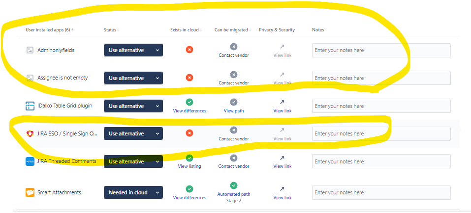

Arvind Swarnkar
March 19, 2024

Please find this step during migration
How I can overcome with these plugins,
Walter Buggenhout
March 20, 2024
Hi @Arvind Swarnkar,
I hope you are still in the testing stage of your migration - if you already migrated in production, you may be facing a tough time fixing all these things now 😳
For the last one (SSO), Atlassian has its own solution in cloud, Atlassian Access. If you need Single Sign On in cloud, read up the documentation online and assess if you need it. It is a separate subscription that you need a license for and that has its own setup.
I am not familiar with the other two apps, but the message basically means that there is no automatic path to migrate those apps (and the features they provide) to cloud. As cloud and server are technically totally different platforms, certain features cannot be implemented in server the same way. Some apps simply don't exist on cloud or there may be different, often native ways to provide the same or similar functionality.
You'll simply need to:
  • find out where these apps are used in your server instance and for what purpose;
  • define if this functionality is business critical for your team;
  • as the app assessment tells you: reach out to the vendor of the server app to find out if there is any way to migrate the features to cloud manually;
  • seek alternatives if this is not the case
  • come up with a plan to migrate / replace / drop some of these features
Like Ste Wright likes this
Arvind Swarnkar
March 21, 2024
Hi @Walter Buggenhout
Thanks for your detailed response.
Yes we are in testing phase.
here AdminOnlyFields and AssigneeNotEmpty are custom modules developed and customized through code in Jira server.
If you could help me how to write custom code/Custom plugins on Jira cloud,
Any provision for Database access in Jira Cloud.
Thanks.
--arvind
Walter Buggenhout
March 21, 2024
Cloud has automation rules as a built in feature and that - as well as standard workflow conditions / validators - may allow you to cover a lot of the automated stuff people used to do on server.
I can tell you that cloud has 2 development frameworks, connect and forge that let you do custom development. But be aware that the platform is technologically completely different than server, has a lot of capabilities that did not exist on prem or are done differently and that you should NOT try to just replicate what you did over there.
Also, forget about access to the database. You don't have it in cloud. If you want to manipulate data, that goes via the REST API.
I would strongly recommend you to go to the drawing board first to list the features you have currently built, determine if you really need those, check if you can implement them in cloud using native functionality and only after that start looking into custom solutions.
You may want to seek help by engaging a solutions partner in your area. They offer (commercial) services that may help you save lots of time and headaches in helping you migrate.
