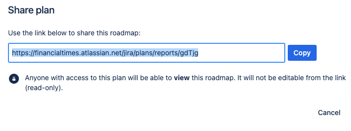

Hi @André Filipe Vilar ,
Try to use Share as button on the right:
Then a link will be generated with a read-only access.
To even restrict it more precisely you can filter only those issues, which you want the supplier to see and then create a new plan with this filter as a source.

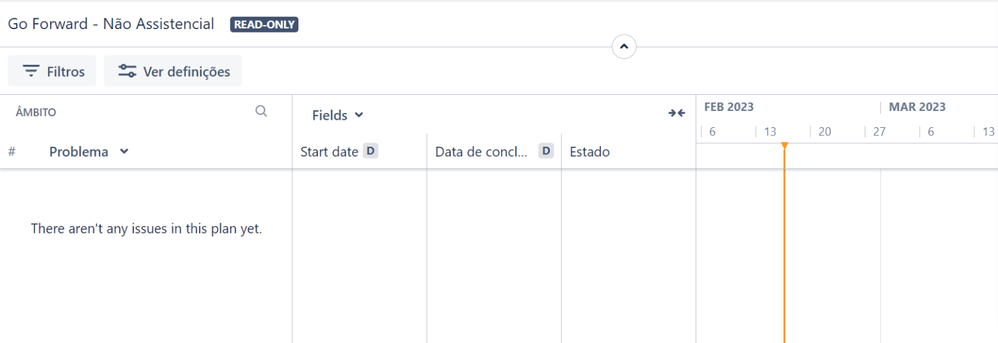

Hi @Magdalena Zhisheva ,
Thank you for the answer.
That was what I have done . I have shared the link using that option. The user can open the link but has the following error (again, the user doesn have access to project and we dont want to give it, but we need that he can see the issues in the plan - the filter that is being used in the plan is shared with that user):
What I am thinking of is making a issue security schemes and grant the supplier access to the project and restrict it with those schemes - https://support.atlassian.com/jira-cloud-administration/docs/configure-issue-security-schemes/
Otherwise, the supplier can't see the issues even in the Advanced Roadmap

André Filipe Vilar
February 23, 2023
Thank you @Magdalena Zhisheva - it worked! :)
