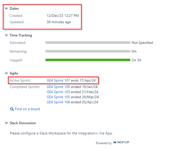

Plan:
Ticket GE4-10281 with active sprint ending April 17 and no start/end dates:grafik.png
Michelle Melancon
April 9, 2024
@Max Merkel  Ok Thanks for the detailed description. Very helpful!

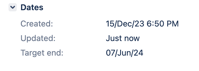

In AR if you have the "Use sprint dates when issues don't have start and end dates" enabled you'll see the sprint dates in the target end date populated with the s lozenge as you also show in your screenshot. This correctly reflects the updated target dates when a story is not completed in a single sprint. However, it is NOT a set target date, its showing the sprint dates more as a reference, which is why you don't see the target end date populated on the issue itself in Jira.
You would have to set that date and save it to jira to show it as a set target end date.
Screenshot 2024-04-09 at 12.04.35 PM.pngScreenshot 2024-04-09 at 12.03.42 PM.png
I hope this helps!
