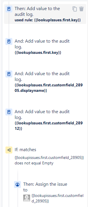

One thing I would advise you to do is insert 1..n Log actions just before that Advanced Compare and print out the following smart values
{{lookupIssues.first.key}}
{{lookupIssues.first.customfield_28905}}
{{lookupIssues.first.customfield_28912}}
Do this to ensure that the rule is looking at the issue you expect and finding the values you expect in those fields. Then try running the rule again.

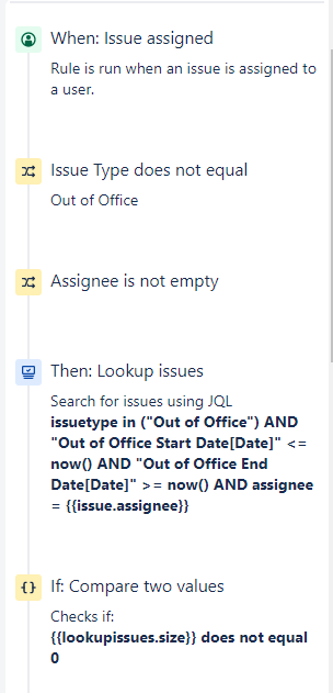

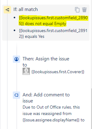

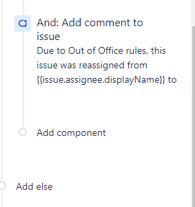

Here are screen shots of the entire rule that includes your suggestion to log the custom fields to ensure that the correct values are being logged.

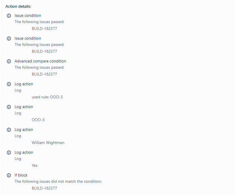

After running the rule here is what the audit log shows.
William Wightman is the 'Coverer' or customfield_28905 and Yes is the Auto Assign or customfield_28912.
It is showing that the if block did not meet the condition (the field does not equal empty)  even though it is displaying as William Wightman.

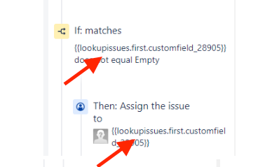

Your problem is here:
{{lookupIssues}} is case sensitive. The "i" in "Issues" has to be capitalized.
