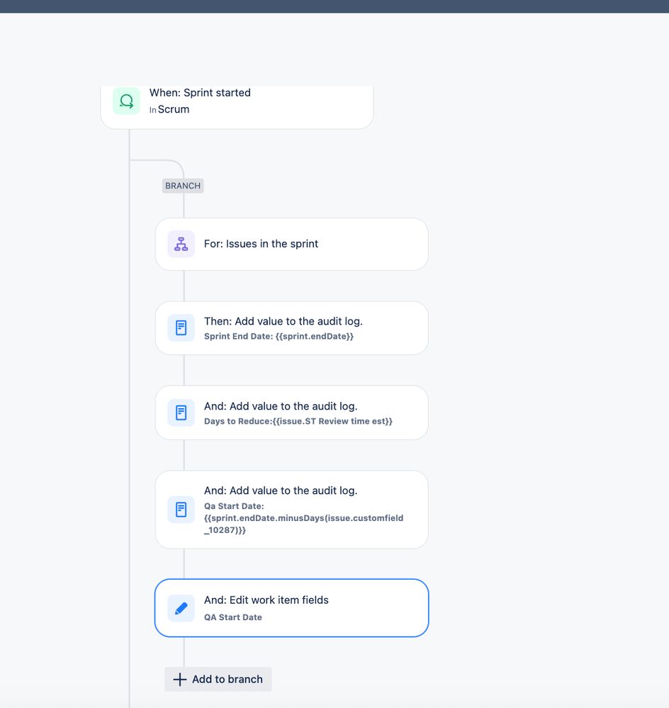

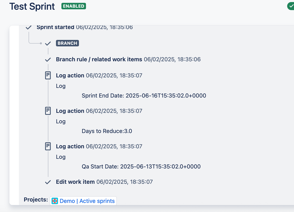

arielei
June 2, 2025
Hey @Bud Herz
So build to following automation, from global automation:
Trigger: Sprints Starts
Branch on: For Each: issues in the sprint
Edit work-item:
field = Qa Start Date
Value = {{sprint.endDate.minusDays(issue.customfield_10287)}}
** Replace the "10287" with your custom field number.
you can also add logs if you want to view the runs.

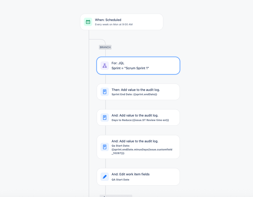

arielei
June 2, 2025
Hey @Bud Herz
Easy :-)
First, Copy the automation you have made.
Replace the trigger to "Scheduled" (do-not set any JQL in it!)
New branch : based on JQL: Sprint = "Sprint Name"
and keep all actions as in the original automation.
after run - disable it so it wont run on the schedule date :-)
