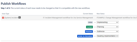

Statuses can't be removed from active workflows.
  1. So you need to create a copy of existing workflow.
  2. Make modifications as required in copied workflow.
  3. Map  modified workflow to the required workflow scheme.
    When you map it, jira will ask you for the required mapping from old status to new status for the BUG ticket type. You can select the required status there for the existing tickets.
    Below is an sample screen how it looks for mapping

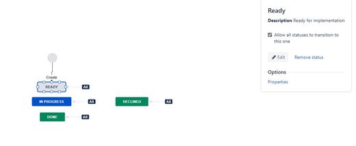

So the only way to rename the entries is to copy the workflow and apply the new worflow to the projects?
If I take a closer look into the current workflow I'm able to click "edit" and can adjust the displayname from "ready" to eg. "open"
But that is not a suiteable approach right?

Renaming is possible, but you cannot delete it in active workflow.
Renaming a status will renaming the status in all other workflows if the same status is used.
Limitations of an Active workflow and inactive workflow is mentioned in https://support.atlassian.com/jira-cloud-administration/docs/work-with-issue-workflows/
