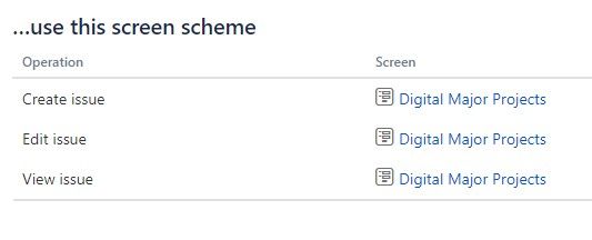

From the left panel, select Project settings, then click on Screens. You should then have something that looks vaguely like this, with one or more links to screens

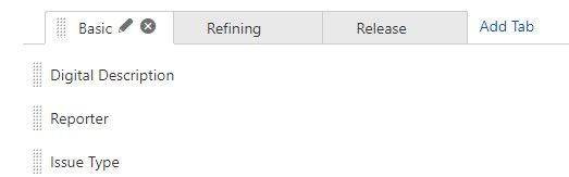

Click on one of the links (you may need to do this again for the other links if you have different screens, we don't) and you should have a screen with one or more tabs, like this
At the bottom of this screen, there should be a Select field dropdown, and you need to add those fields to one of the tabs. If you can't see them in the dropdown it most likely means they're already in one of the tabs and you can move to the next step.

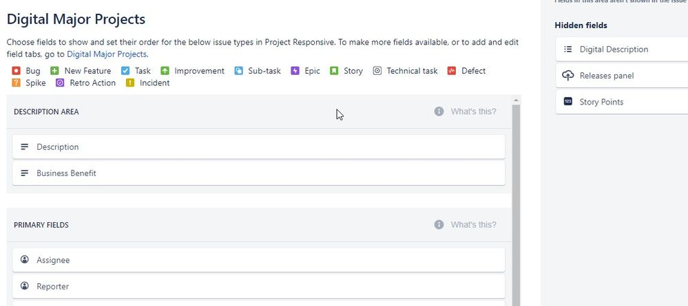

Go back into your project and again select Project settings from the left panel. Then click on Issue layout and click on the Edit layout link, to be presented with a screen similar to this
The fields should now be somewhere on this screen, in the Hidden fields section or under Secondary fields - they can be dragged into any other section to show where you want them

project settings/issue layout/edit layout: when I go here, all I can do is drag and move the fields, I can't change or add anything
project settings/screens: when I go here, it says to go to issue layout
