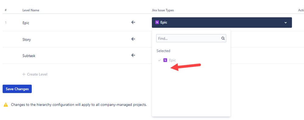

Hi All,
I would like to add one more issue type as Epic. However message saying "Moving or changing hierarchy levels of issue types will break existing parent links in all company-managed projects in your site. This change can't be reversed." is bothering me a lot, I want to make sure that this action will not mess up other projects. So, my structure would like on a screenshot - default epic type will remain, I will add one more. Will that mess up hierarchy of the projects using default epic type?epic issue types.png

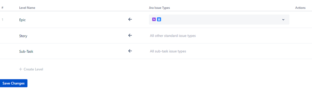

I want to add another Epic-level issue type. I've created a new Issue type (I call it "Container"), but it's of "Base" type and is not "Epic" type on creation.
 Then I did as in the image above - changed the hierarchy for the new type to be on the same level as Epic. (let's ignore for now the cumbersome message that also puzzled me)

@Aleksandar Djokic , how did you get it? I mean the second issue of the level =1.
It looks like a miracle to me. There are lot of places, where it is written that it is impossible.
Has anyone managed to reproduce it?

You go to Admin -> Issues -> Issue Type Hierarchy, and click on the field you have pointed to in the screenshot.  That gives you a drop-down list of issue types (divided into selected and available), which you can then click on to add or remove them from that layer in the hierarchy.

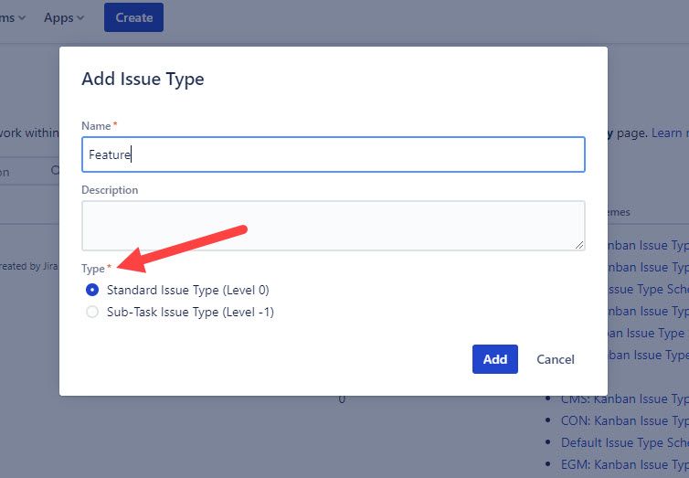

You're in the right place, and the wrong one at the same time!
Your screenshot is of the place where you can create issue types.  You should go ahead and do that, using a standard issue type (not sub-task)
Jira's core only actually has two classes of issue type - base (standard) and sub-task.  You can't create other classes of issue type directly.
Technically, in the background, Epics are base issue types, there's just a pile of code that recognises them and handles them differently, and in systems with Advanced Roadmaps (or certain other apps), more so.
So, to get another issue at the layer of Epic, you need to do two things:
  • Create a base level issue type with the name you want
  • Follow the instructions in my previous comment to get it added to the Epic layer

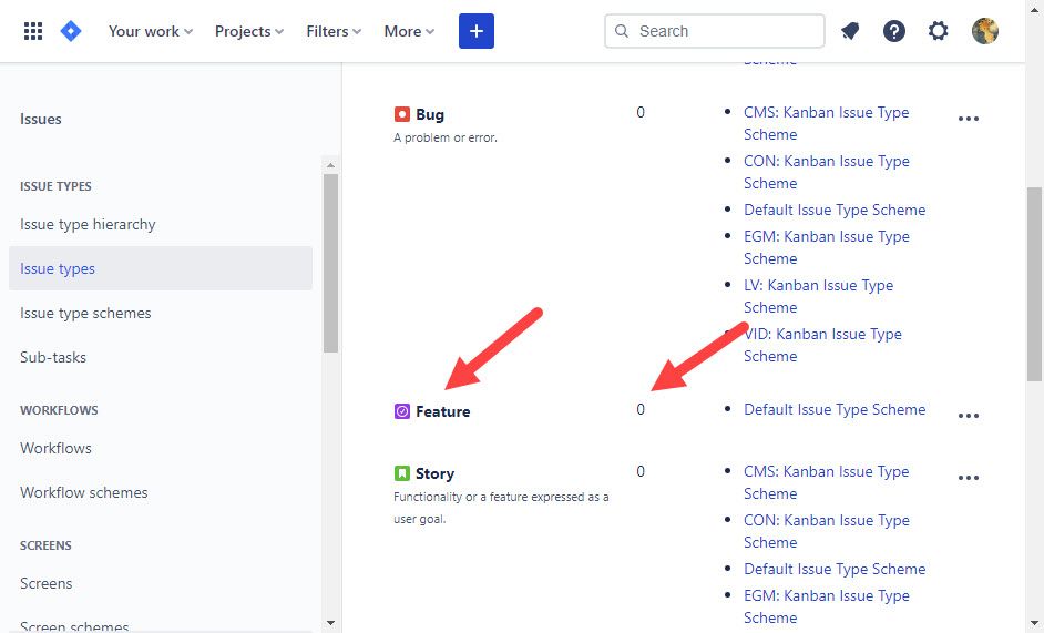

1. I have created the much desired Feature issue type at the level 0, i.e. the same level as Story, Task or Bug.

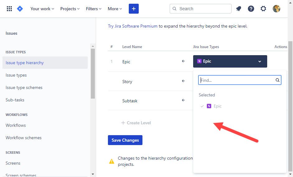

Then, I go to Admin -> Issues -> Issue Type Hierarchy and see nothing to add to the level of Epic.2023-07-29_12-05-51.jpg
My instance of Jira is Cloud, the Plan is Free.
May the problem be in that?
Nic Brough -Adaptavist-
July 29, 2023
Note the first line below the menu in your screenshot - you don't have Advanced Roadmaps, so you can't change the hierarchy.
Like Roman _Romanik_ likes this

Technically speaking, I don't want 'expand beyond the epic level'. It is explicitly stated to be impossible for a Free Plan. I just want to stay on the epic level, not 'beyond' it.
Anyway, I suspect this is the quesion of the Premium plan or not. I'd love to have it mentioned somewhere clearly.

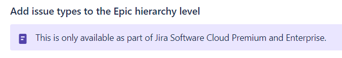

I needed to create one more issue type at the epic level, and yes it reuires premium.
I switched to premium trial and than it works. You can then add more levels or set more than one issue type in the level of epic.
