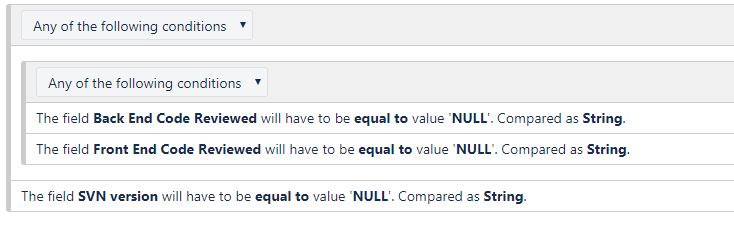

Hi @Sreenivasaraju P
Thanks. Sorry for the late reply, I have tried your solution but its not working for me yet. I wanted to compare both NULL and not null condition at the root level.
If I can write some psudo code, I Here is what I am trying
If( SVN == NULL)
  IF (Back End Code Reviewed == NULL OR Front End Code Reviewed == NULL)
        Close JIRA issue
ELSE IF (SVN !=NULL)
  IF (Back End Code Reviewed != NULL OR Front End Code Reviewed != NULL)
        Close JIRA issue
I am not able to put the second condition somehow.
 This image help you understand better.  Appreciate your help in this regard.
Thanks
Prashant

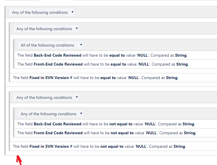

Prashant Deshmukh
July 30, 2018
I could change this a bit but still not able to achieve the expected outcome. Here is how it looks now. I guess the external nesting (pointed by red arrow) is causing the problem. Do you see any solution?
Thanks
Prashant
Like Pavel Braun likes this
Nic Brough -Adaptavist-
July 31, 2018
I suspect it's because your nesting is not doing anything.
At the top level, you have two condition groups joined.
The first group says "The field fixed in svn version # ... equal to null".  The second says "The field fixed in svn version # ... not equal to null".  As the join is "any", then you are going to find that every issue matches the joined condition.

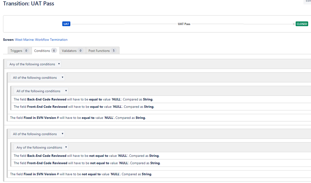

July 31, 2018
If/then are another way to express the logic, they don't do much different.
A set of conditions should lead you to a simple boolean true or false.  You can express them as if/then, or as and/or statements or a mix when you're coding, but for conditions in Jira transitions, you have to use and/or.
Look at the second layers of nesting in your conditions - they should be "and", not "or"

Prashant Deshmukh
July 31, 2018
@Nic Brough -Adaptavist- It worked :)
I have changed the conditions and now I am getting the expected result. Here is what I have changed based on your reply.
I thank you both @Sreenivasaraju P and @Nic Brough -Adaptavist- for the help.
