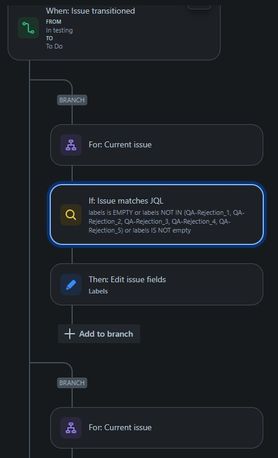

I tried 2 different approaches:
1st approach using advanced branching --> this behaves like a for loop and loops over until final label is reached
2nd approach using if/else if --> this works fine for the first iteration, so it adds the "label-1" but then every time it succeds (success in audit log)  but there's no any change
Looking for any ideas how to fix that!
Matt Parks
May 2, 2024
In your first condition in the if/else loop, you have both "labels is empty" and "labels is not empty", so it will always meet this criteria. I think you need to adjust that condition.
Michał Nowak
May 2, 2024
Hello Matt,
Thanks for your answer - there are OR operators everywhere
Oliver Siebenmarck _Polymetis Apps_
May 7, 2024
Hi @Michał Nowak ,
 I think that's exactly what @Matt Parks  is getting at. Your condition is "labels is empty OR labels is NOT empty", which will always be true.
If you can rely on the labels being applied correctly, I would build my conditions just with that, like so:
labels not in (label_1, label_2, label_3, label_4, label_5) => add label_1
else if labels = label_1 => remove label_1, add label_2
else if labels = label_2 => remove label_2, add label_3
..and so on.
