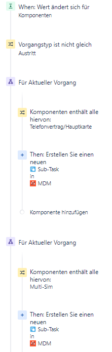

Adding a specific Sub Task trough out an automation by adding the specific field value
Felix Gelfert
March 17, 2022
Hi,
when I have already entered "Telefonvertrag/Hauptkarte" in the field "Komponenten" , I would like to be able to subsequently add the value "Multi-Sim" without having to re-create the subtask for the already existing value again. In other words: If I subsequently add the value "Multi-Sim" to the field "Komponenten", I want to get created only this specific sub task.
How can I edit my automation to get there?
Thanks!

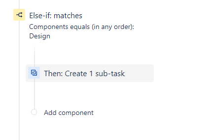

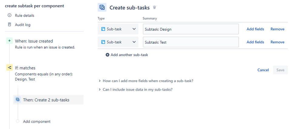

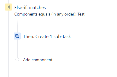

So here comes my approach: First of all i would split the requirement into 2 automation rule:
1. when issue is create
2. when value for field "Components" changes
The first rule with trigger "issue created" is built with an if/else block (see screenshot):
- if issue is created with both components --> 2 Tasks created (1 for each component)
- else if issue is created with one compoent --> create subtask for that component
- else if issue is created with other component --> create subtask for that component

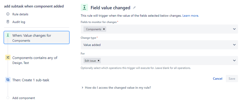

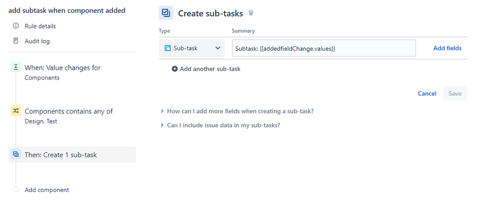

2. rule: when value is added to component
Please let me know if this approach would solve your problem.
Best
Stefan

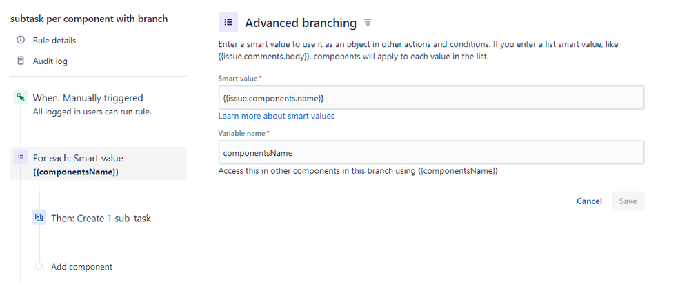

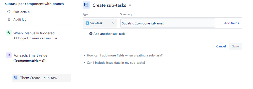

Hi @Felix Gelfert
Even found an easier way for the first rule (on "create issue"). The branch iterates through list of components and adds a subtask for each list item:
Best
Stefan

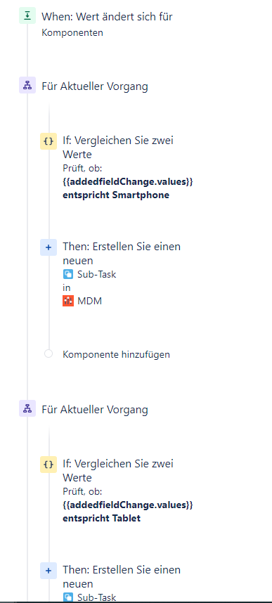

Felix Gelfert
April 21, 2022
Hi @Stefan Salzl ,
thank you very much for your awesome Support!!!
You actually gave me the hint i needed to solve my problem!
I´m using your smart value to run the second rule and it works pretty well.
Best
Felix
This is how i finished it up:
