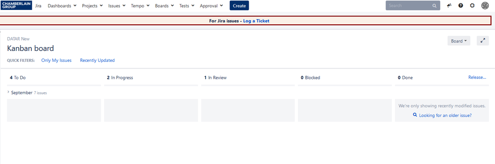

This may be an unorthodox way of trying to achieve my madness.  I cant seem to properly configure swimlanes with custom queries. I'm trying to create multiple swimlanes 1 for each month. Such as "September", "October", "November" etc. What I want to do is utilize the "Due by" field I have on my Jira tickets so they appear on the teams Kanban board and know what upcoming work is available in the to-do column for that given defined swimlane.
So for the current month "September" I added a custom query "Due by" < endOfMonth() and assigned tickets with a september due date. Seems like it works fine. The moment I add "Due by" < endOfMonth("+1") to "October"  where things start to break. Tickets seem to not want to appear with October Due dates. When I switch it to Oct 4th due date then it appears the moment I add a week it disappears.

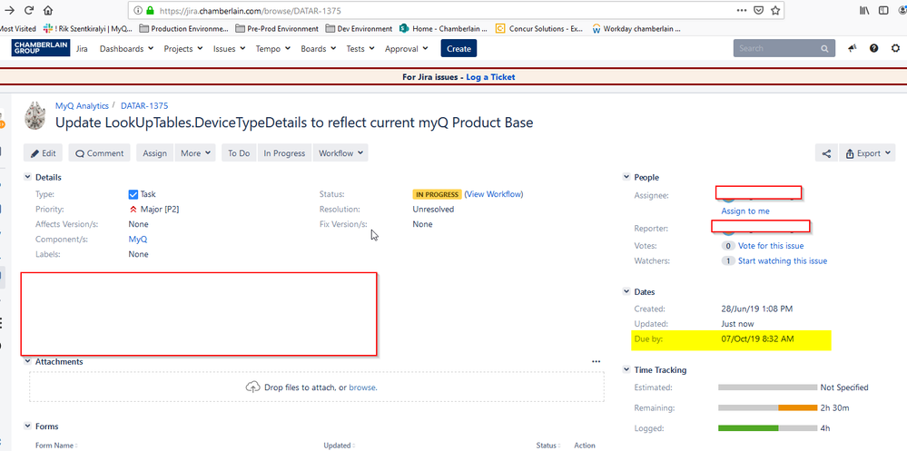

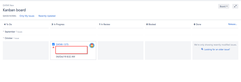

Thanks for the advice. Something definitely weird is occurring because it pulls in tickets dated up to Oct 4th, however any tickets dated after the 4th do not appear on the board/swimlane. What could the issue be? 3rd Image shows the ticket dated the 4th and it appears exactly as expected. The moment the due date is changed it no longer appears. Same goes for any new/additional tickets assigned a due by date past Oct 4th.
Two Issues Discovered:
- Setting a "Due by" date of Sept 1st renders ticket to not appear on swimlane/board
- Setting a "Due by" date after Oct 4th renders the ticket to not appear on swimlane/board.
