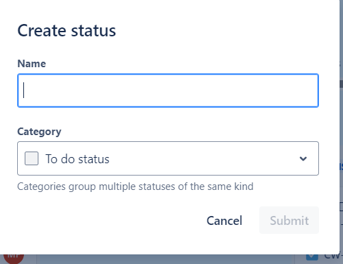

We are trying to add a column to our board, me and my co-worker both have administrator level of access and I'm the Project Lead. We looked up how to add a column and did that, however it gives us an option to "Create a Status," not sure what that means and then when adding that the column or "status" is grayed out and not bright like the columns. How do you add a column now because everything I've looked up that we've tried is not working for that.

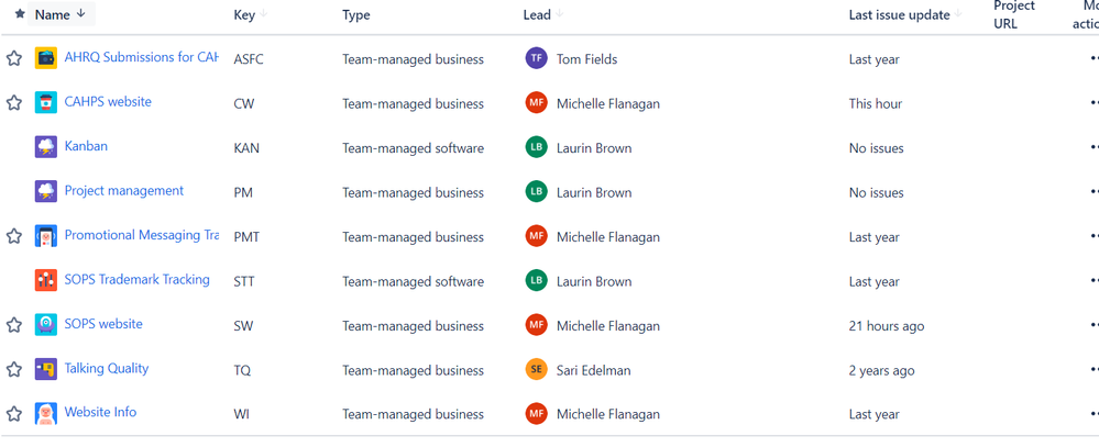

The first question we need you to answer is what type of project are you using?
To get that information go to the Projects menu and select the View All Projects page. Find your project in the list, and tell us what it says in the Type column.

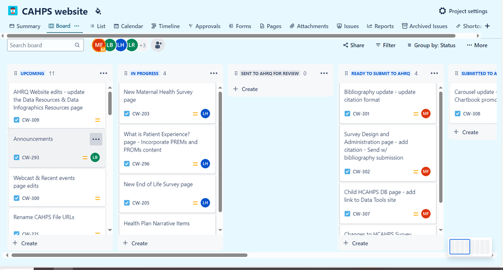

Hi, thank you, looks like we use a "Team-managed business" type project. I think I can access both. When I click on the gear by my avatar this is what I can select below. Please see screenshots of level of access and the new board we created is called "Sent to AHRQ for Review" and it looks very different than the rest of our original columns...We used to be able to just click on the + sign all the way on the right and simply add a column. We never got this "Create Status" box. Is that how it is now?

With a Business project, you get one board created with the project itself. That is the board you shared in this image. Business projects get one and only one board like this.
In a Business project board, each column is a Status for the issues in the project. Statuses tell you what "stage" of work the item is currently in; i.e. To Do, In Progress, or Done.
When you add a Column that is equivalent to adding a new Status to your workflow (the stages/statuses that the issue progress through). That is why you are being prompted to provide a Name for the Column/Status.
The pull-down list below the Name field is asking you to identify the Status Category for this new Status value.
Jira has three Status Categories. They are color coded, and the color is what you see as the background for that Statuses that are in that Category. The Status Categories and colors are:
Status Category Name  Color
To Do  gray
In Progress  blue
Done  green
Every individual Status value is associated with one of these Status Categories.
When you add a new column/status to the Business project you have to indicate the Status Category to which it belongs.
Since work typically progresses from "To Do" to "In Progress" to "Done", the columns on the boards are typically arranged from left to right, gray > blue > green

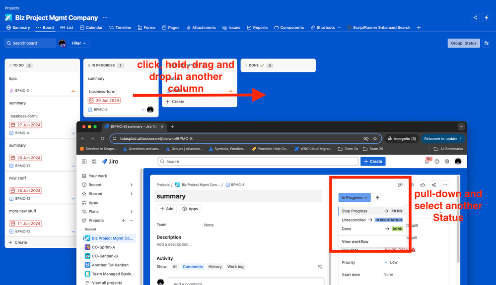

A board is a way to visualize and manipulate work items. The work items appear as "cards" on the board. The board columns typically represent the various stages a work item goes through, from inception to completing the work for that item. The work item card moves from one column to another as it goes through its lifecycle.
Looking again at your board image:
Each card in those columns represent a work item for which work needs to be done.
A work item can be in various statuses throughout its lifecycle. It might initially start in a "To Do" status when the work item is first created and no work has yet been done to complete the item. When work starts it may be changed to the "In Progress" status to indicate that some work has been done towards that item but the work is not yet complete. And then it might be changed to the "Done" status when all the work is completed for that item.
The changing of status for a work item is referred to as its Workflow in Jira terminology. The Workflow includes all the possible Statuses that an item might be in, and the rules that say how it can transition from one status to another status.

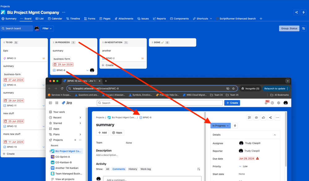

Each column in the board shows the work items that are in a given Status at that moment. You can click on a card to see the details, and see that the name of the column corresponds to the Status value for that card at that moment.
You move the work item / card through its lifecycle from "To Do" to "Done" by changing its Status. You can change the Status of a work item by:
1. In the board, left-click and hold on a card, drag it to another column, and release/drop it in that column.
2. View the details of the work item, pull down the Status field, and select the new Status for the item.

Looking at your board I see various work items; i.e.
CW-293 Announcements
And I see various Status values; i.e.
Upcoming
In Progress
Ready to submit to AHRQ
Submitted to A...
Does the work item CW-293 Announcements progress through these Statuses? In which Status does it start? And which Status does it change to next?

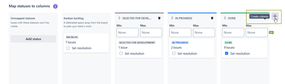

Adrián García González
January 10, 2025
Hi @Michelle Flanagan,
Columns are used to display issues and issues will be placed in columns according to the status we have assigned in the project workflow.
To add new columns simply use the + button in the dashboard configuration in the Columns section. I leave you documentation about it: https://support.atlassian.com/jira-software-cloud/docs/configure-columns/
I hope you find it helpful, best regards!
Michelle Flanagan
January 17, 2025
Thanks, when I click the plus sign on our board this is what comes up for me, a box that says what's below.
