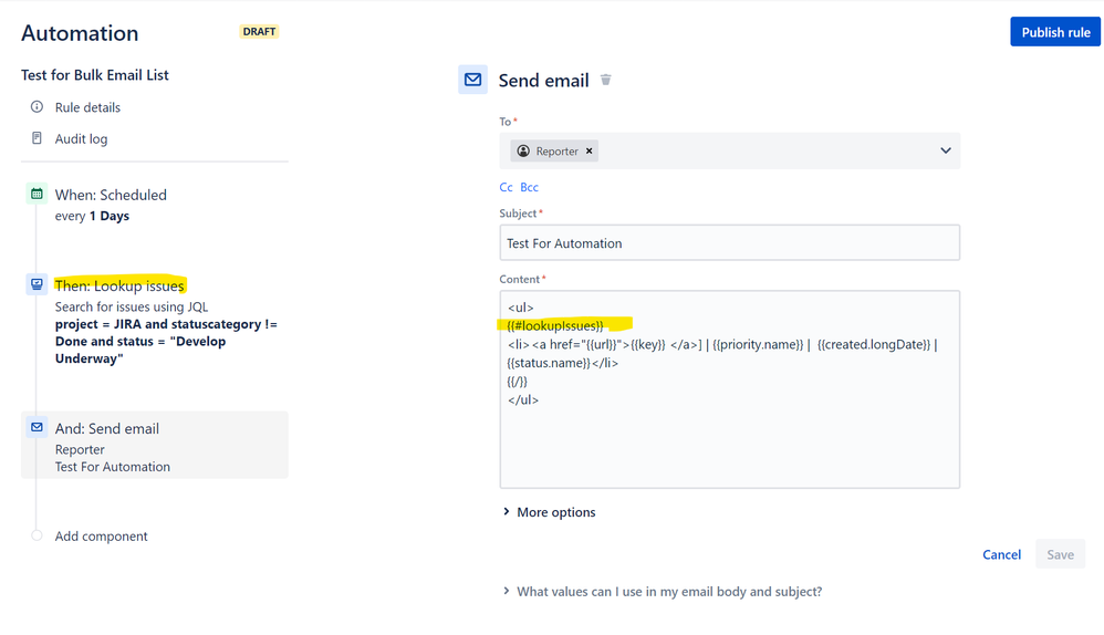

Hi Theresa - Welcome to the Atlassian Community!
Try creating an Automation Rule using a scheduled trigger with the lookupIssues function. Here is an example:

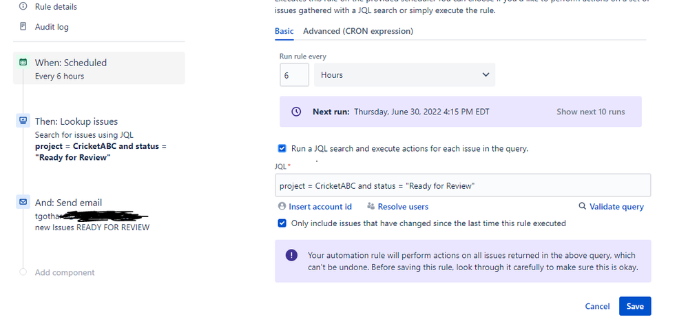

Theresa Gothard
June 30, 2022
Hmmmm...seems that I'm not doing something correctly.  I'm running it after I change the status of 2 issues, but when I get the email I'm receiving 2 separate emails with all the issues in that status.  I'm obviously missing a step.  Any idea?
John Funk
June 30, 2022
Let's try two things.
1. Change your JQL to this:
project = CricketABC and status = "Ready for Review" and status changed to "Ready for Review" after -6h
2. Click off the box for Only Include issues that have changed.
Let 's see what that does.
